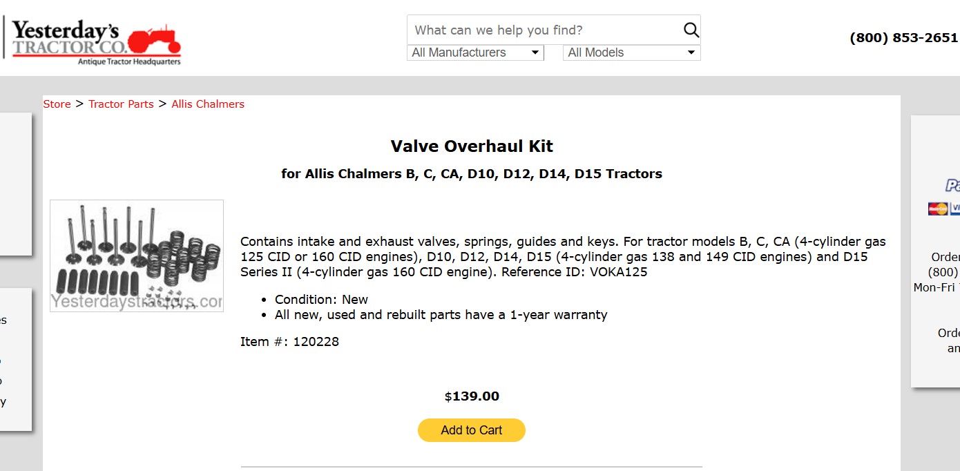

I took the head of in 15 minutes. You gotta love tractors. the valves in 3 werent seating properly, and the ex valve in 4 was chipped away. So that explains that.
gonna order some parts, and have the valve seats redone. I finally got the book on my tractor/forklift, and the book says I have a Power Crater 160 motor, but I cant find much info on them, anyone know?
apparently there was also a perkins 3 cyl that was called that as well.

That engine series started as a 138 cubic inch in the D10- 12 ... Later that was bugger bored to 149 and many in the D14 and D15 farm tractors.... Last update was to 160 inch for the D15 series 2..... GOOD MOTOR !!
I think valves / springs / "parts" for the D14 and D15 149 motor should all fit, except the BIGGER PISTONS...

couple of sites list a different part number for the later D15 II engines ( i think they mean the 175 cid diesel)-- ( valve kit).. some site list them as all the same..( gas??). VERIFY with vendor prior to purchase..
