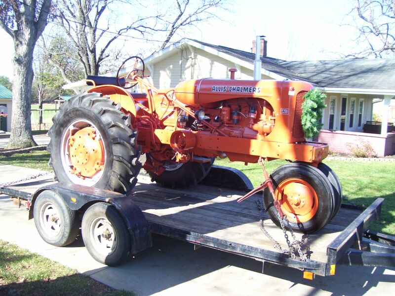

I use one chain through a clvis on the back and two binders on front.  I hook one end og the binder to the frame rail lip behind the engine cross member.

hooked on the bottom of the frame rail doesn't hurt any paint, unless you are inspecting the bottom way too close.  I like the fact that there are no hooks or such permanently attached like I see at so many shows.  I assume the post above was talking about down the stake pocket and back up the side of the stake pocket inside the rub rail, at least that's the way I took it.
Anyone see a down side to hooking like I have pictured above?  I don't want to be doing something dumb that I am missing.

AllisNut, If DOT pulls you over they will bust you for hooking like that, your suppose to always hook chain hook to chain. At least thats what a Motor Carrier officer told us at one of our local tractor club meetings.

i thing hooking  hook to link it ok the way he has it.. i would bust him on having extra lose chain laying on the deck. that could vibrate off and drag down the road.. when i haul my wd45 i place a chain on the front tires agaisnt the pedistal (didnt spell that right) then pull back on the front end .. the rear is chained over the draw-bar with a twist then pulled agaisnt the front end.. i should mention i always back the tractor on so it owuld flip over on me. also always put the load-binders on the drivers side  . i always use load-binder locks that way the handles dont move. ill post a pic of how i do it later. this is the way the MTO has told me to do it

Thanks for the info - I never knew I could be wrong in so many ways and not know it.
