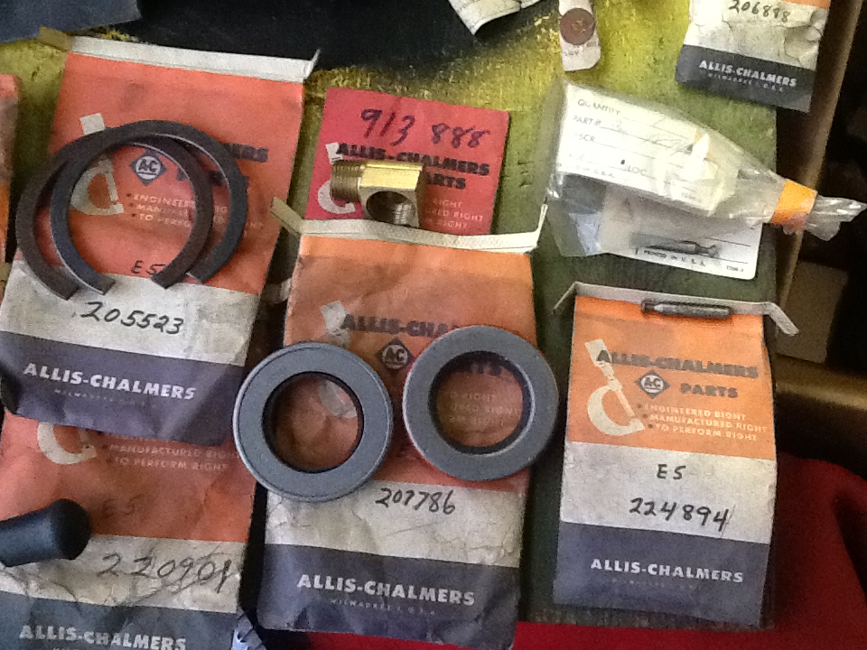

Hi everyone
We came across this bag 207786 with two seals in it. Can't find that part number in any of our books. The seals are national 50055. Can any of you find that number. Thanks

I have several National Seal cross reference books from the 80s and I can't find either of those numbers in any of them.
I have an A-C cross reference book dated 12/31/97 and I can find neither of those numbers in it either.
Hopefully someone else will have better luck.

DON'T KNOW WHAT IT FITS , BUT IT DOES CROSS TO A:   CR 15004
D19 Diesel,D17 Diesel SER.3
2-D14, 2-D15 SER.II WF/NF
D15 SER.2 DIESEL
D12 SER.I, D10 Ser.II
2-720'S D21 Ser. II
Gmc,caterpillar

In the oldest Master Number Index that I have, part # 207786 shows to be a shaft, not a seal and back then it was discontinued with no other notes.

Ok thank you guys. Gues at some point ether my grandfather or the old dealer he bought out. must have reused the envelope.

1 1/4 ID x 1 5/8-(1 11/16) OD ??

Post Options Post Options   Thanks (0) Thanks(0)   Quote Mikez Quote  Post ReplyReply Direct Link To This Post Posted: 08 Jan 2020 at 6:18pm
It's about 1-1/16" IDx 2-3/8 ODx 1/2 thick
