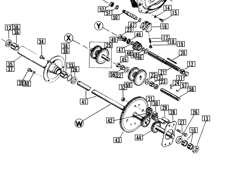

Just got an 8 scamp. Got it running, drove about 800' and transaxle stopped. Leaked oil then ran with no oil and have oval hole where bushing use to go. I can probably mill bigger then make big bushing to press in. But one gear looks rough. Anyone know if any parts are available or a place to try. Thanks

Its two of the four gears the axle gear contacts (all four the same). Maybe the forward reverse system. I'll see if i can upload pic tonight. I hardly get on computer anymore.

I believe it is 7/8" wide or long and 5/8" I.D. and 12 teeth

Post Options Post Options   Thanks (0) Thanks(0)   Quote ACmowerguy Quote  Post ReplyReply Direct Link To This Post Posted: 26 May 2016 at 9:41pm
Ist it # 31? If so, it is a differential gear. They are very common and I still got some new ones last year. They are used in the differential on all of the B-Series, 700, and 900 Series. I probably have a couple of decent used ones. Will check tonight.
Josh H View Drop Down
Joined: 24 Feb 2015
Location: Carnesville, GA
Points: 128
Post Options Post Options   Thanks (0) Thanks(0)   Quote Josh H Quote  Post ReplyReply Direct Link To This Post Posted: 26 May 2016 at 9:45pm
Yes i believe that is it
