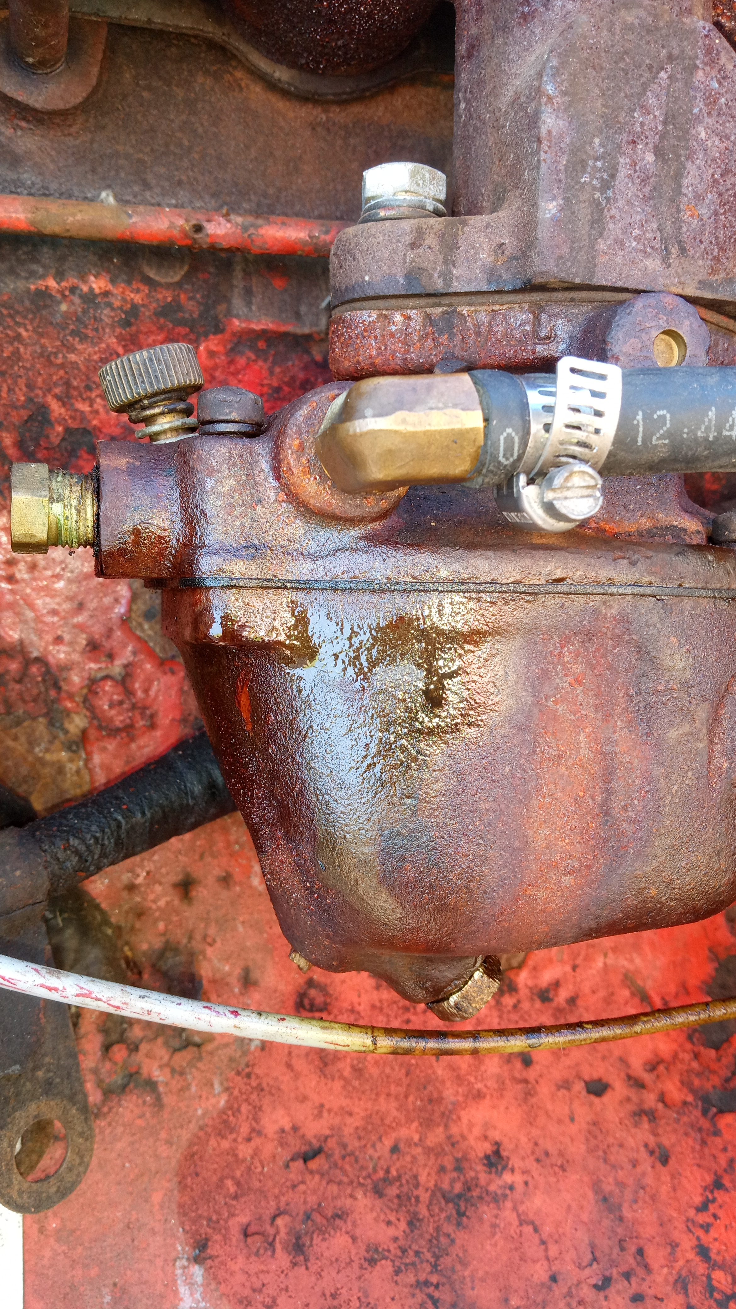

I was clearing up a storm in my pasture yesterday and then my girl started running like crap and would only run with the choke on full.
I noticed some fuel coming out the side of the carb- so I've got myself a vacuum leak. That's my assumption anyway. Pic included, but now I'm wondering if the fuel is coming out of that screw on the end and what that means...

running with the choke on shuts of a major amount of air... normally that means your running out of gas... you have to keep the air fuel ratio right to keep it running..
"Normally" the problem is a chunk of crud got in the bowl and is partly plugging the main jet .... a vacuum leak is a possibility , but not as common.
The plug in the front i think is just another location for the fuel inlet if the carb is used in a different application...
You may not need a "rebuild" .. if it runs too bad, you could pull the carb, pull the bowl and blow things out and reinstall....

you might pull the plug on the BOTTOM of the bowl and drain the bowl... bang on the bowl to see if you can get any floating crud to drain out.
looks a little wet around the bowl gasket ??  Try snugging the 4 slotted mounting screws on top that hold the bowl on..

I'll try the screws and put some thread tape on that fuel port.
I'll drain the bowl and tap on it, too.
Maybe I'll get lucky.
I did rob gas from another old vehicle- it could've had something in its tank or there was something in the bucket. It is possible a jet is clogged. There's an inline paper cartridge filter on it. I always thought those did pretty well. That's all my riding lawnmower has going for it. I did notice while driving that the inline filter is almost empty, but it will fill up after you turn it off.
I'm afraid to take it off and not have it run at all without a gasket set. At least now I can move it if I have to.
It actually doesn't have a sediment bowl- came that way.

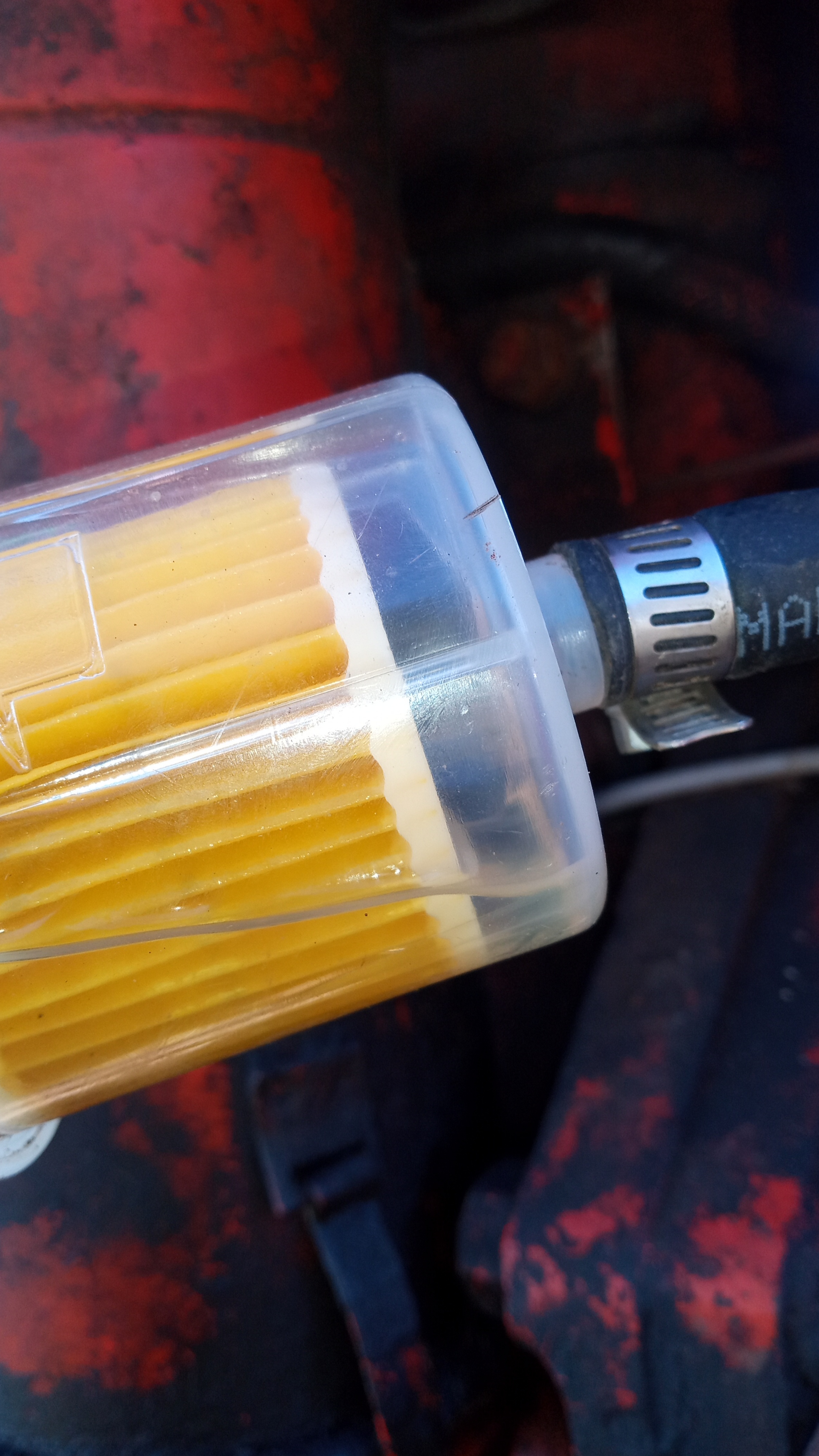

Take that line off by your filter and see if you have adequate flow from the tank. If not blow back to the tank and see if that helps it's a temporary fix you need to see what's obstructing the flow from the tank.

If I unplug the fuel line at the carburetor, the filter fills up immediately and, at least what I think, is a normal amount of fuel comes out.
However, I think it might be worth it to do what you say. Then I won't have to wonder if it's full flow. Check it off.

A  "B" is a great little tractor... Them inline filters are a REAL GOOD IDEA... with or without the sediment bowl..

The question is, does it continue flowing for several minutes. Often these old tractors have a problem with the inlet of the sediment bowl accumulating debris. After you use the gas in the sediment bowl, flow slows significantly and the engine starves for fuel.
I agree 100% with Steve's recommendation of an inline fuel filter. The only filtering these old tractors had was the screen in the top of the sediment bowl. The screens were marginal, at best, for keeping dirt out of the carburetor. The newest an AC tractor could be is 39 years old (and gas tractors much older than that!). There is bound to be some rust/debris in the fuel tanks after that long.

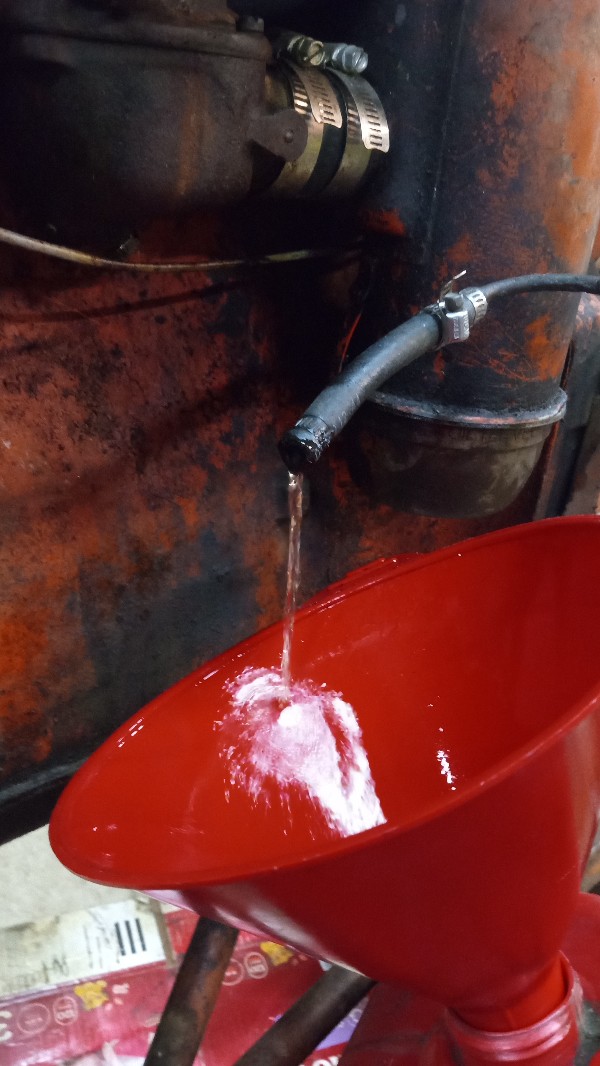

I'm draining the tanm to check it out. Here is 100 percent open on the tank petcock. Good? Bad?
Points: 91040
Post Options Post Options   Thanks (0) Thanks(0)   Quote steve(ill) Quote  Post ReplyReply Direct Link To This Post Posted: 18 Mar 2024 at 1:15pm
that looks like a good flow... assuming there is nothing FLOATING inside the tank to plug it at random times..

Additionally, where the gas was coming out the side of the carb, that screw had rattled loose about 3/4 turn. The one behind it 1/2. The other two 1/4 each. I didn't Tarzan them. Tighter isn't always better when it comes to carbs, I learned the hard way.

Weeeeeeeelll, things are worse now. I flushed out the tank. Cleaned all the fuel lines.
I found out the problem was my filter. My old one was clogged and I had a newer Wix one that when you blow through it, air comes out, but as soon as you put it in line, nothing goes in. I swapped filters with my lawn mower. The mower is now fuel-starved and sad.
With the lawnmower filter on the tractor, plenty of fuel comes out the bottom of the carb bowl. More coming through than could possibly be burnt?
However if you leave the fuel turned on for 30 seconds, it'll be coming out the sides of the carburetor like crazy.
You have to drain the bowl to get it to start and then start it immediately after turning the fuel on.
It still stumbles, but now it backfires.
It still only runs with the choke full on, but now the smoke is black and stinks. Before you couldn't smell it.
It seems to have a little more power and oil pressure is better. It's much worse for the operator in terms of air quality and the exhaust pipe is turning black around the top like a diesel would, lol.
I tried to use the fuel shutoff valve to limit how much gas goes in, but didn't have much success.
My guess is that now it's too rich: Float is stuck or the needle and seat are worn.
If gas is coming out the side of the carb, that means air can get in, too?
Edited by resurrection20 - 19 Mar 2024 at 5:56pm
Points: 91040
Post Options Post Options   Thanks (0) Thanks(0)   Quote steve(ill) Quote  Post ReplyReply Direct Link To This Post Posted: 19 Mar 2024 at 7:02pm
gas is coming out of the BOWL GASKET ??  The LEVEL should be about 1/2 inch below that... so YES.. you float is stuck, has a hole, or the needle is worn out !
Points: 91040
Post Options Post Options   Thanks (0) Thanks(0)   Quote steve(ill) Quote  Post ReplyReply Direct Link To This Post Posted: 19 Mar 2024 at 7:04pm
as the LEVEL Gets too high, the gas runs over the top lip into the throttle bore area and gets sucked into the motor for uncontrolled gas flow.... BLACK smoke is Excess fuel.

My B would not run right with inline filter so I ended up just staying with the sediment bowl.  There are probably filters that work but the one I had was too restrictive.
