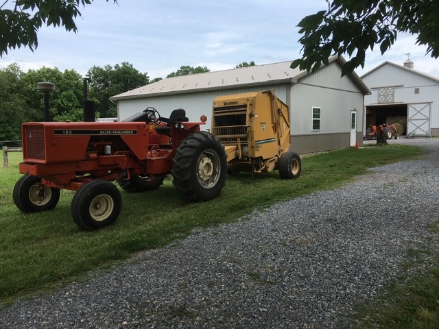

I have an older Vermeer 504 SI that requires (1) two way remote and electric tie that runs through the monitor. I run it with a 185 but believe a D17 would do it(not in silage), May make it work a little. These are open throat Balers and very reliable.
Edited by allisbred - 25 Jun 2020 at 8:52pm

Post Options Post Options   Thanks (0) Thanks(0)   Quote allisbred Quote  Post ReplyReply Direct Link To This Post Posted: 25 Jun 2020 at 9:08pm
