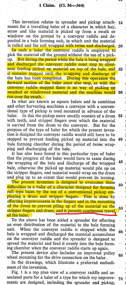

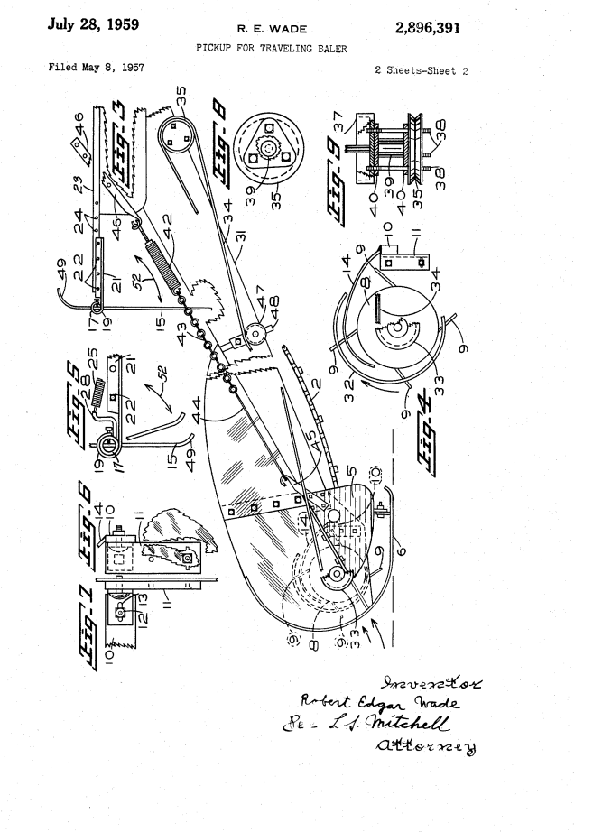

Bingo: Found the original patent from Wade relating to their continuous pickup for a rotobaler. They clearly couldn't (or didn't want to) specifically mention 'Allis' or 'Rotobaler' in the patent application for liability and/or adaptability concerns. Read the two highlighted paragraphs in the lowest picture for mention of 'continuous' operation. https://patents.google.com/patent/US2896391A/en?oq=US2896391A

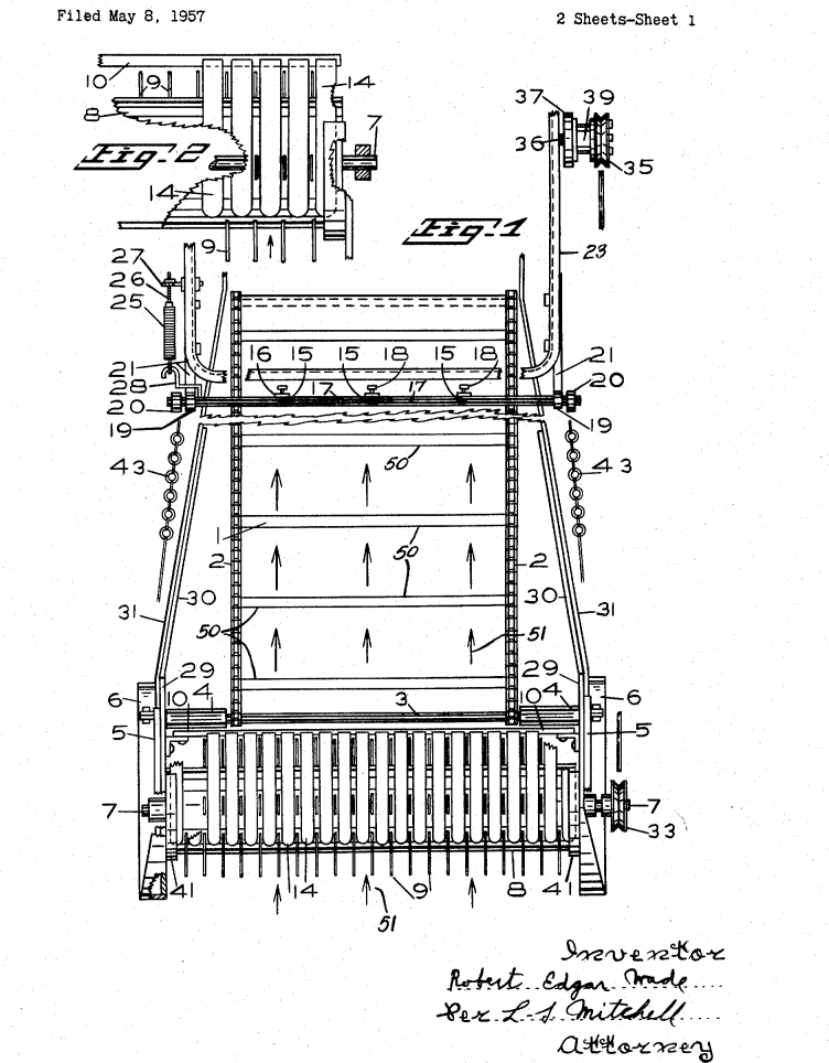

Overhead view from Wade continuous pickup patent mentioned in my last post. Somehow missed attaching it.
