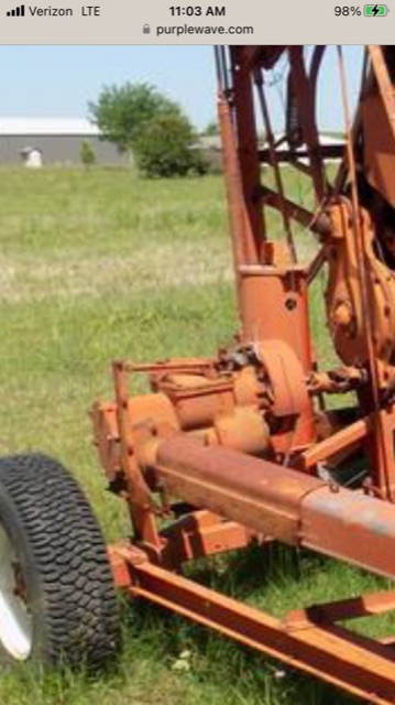

Have always wanted a rotobaler and I found one that’s about 100 miles away. How much of a pain to tow would this be? Does the tounge swing over to make it narrower? How wide is one when towed? I know I’ll have to stop to grease the wheels often, I’m not sure if there’s a loader on that end to load on a trailer so towing may be my best option. It’s an orange top if that makes a difference. Just want to know what I may be getting in to. Thanks

What is the gearbox? on the driveline for, why do some rotobalers have it and others don’t? It this the fast wrap that I’ve heard about?
Yup, I believe so, but I've only seen one once, and that was on a baler sitting in a fencerow. They had an electric overdrive that would kick it into warp speed when the twine arm dropped. My understanding was that some of the (many) problems with the continuous functionality/bakcfeed conveyor of the #10's was when the high speed tie didn't kick in: Didn't tie fast enough and while it was wrapping, hay kept accumulating and built up too much backlog ahead of the pickup.
Of course, there were many other issues with the #10's continuous baling functionality - that was only one small part of it. The ones I've seen had to maintain  a pretty slow ground speed, or the upper bypass conveyor would backfeed and drop too much hay in front of the pickup and would start rolling hay into a ball right in the pickup where it was dropping. It was a pretty wacky idea to begin with: The baler was designed to be fed at a certain rate, and suddenly during the bypass period you're feeding twice as much for a short period once the bale ejects. So you either have to maintain a slow enough ground speed to handle twice the feed rate, even though you're only handling it for a small portion of the time and the rest of the time you're not using the baler to its full pickup potential. Or you travel at a decent speed to use the baler's normal pickup capacity, then it gets over-crowded when it does its bypass thing and starts balling up in the pickup.
I think Allis had some of the best engineering in its time, but for that particular instance someone didn't know how to design for steady-state operation.
Edited by DanielW - 08 Nov 2023 at 12:25pm

Basically an electric over drive,I have a parts baler with one on it.
