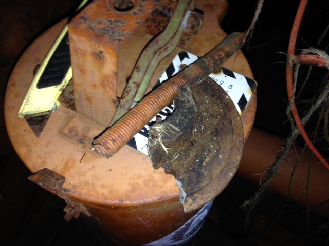

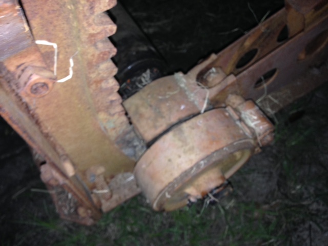

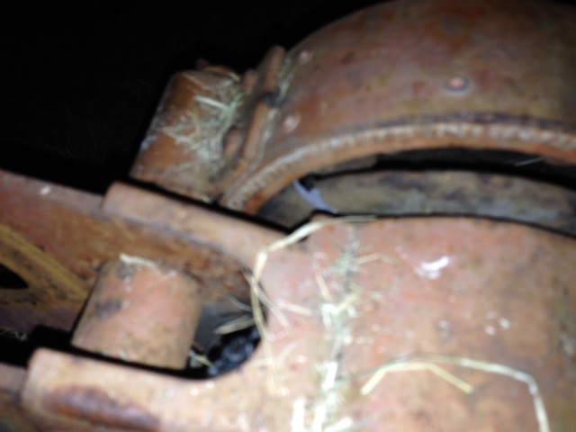

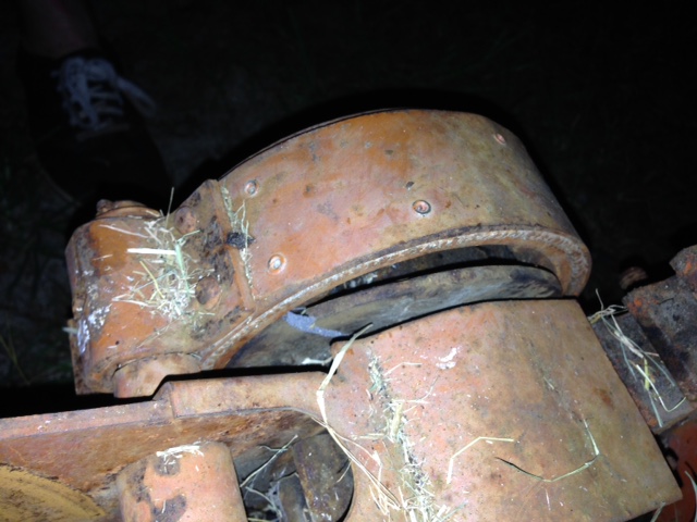

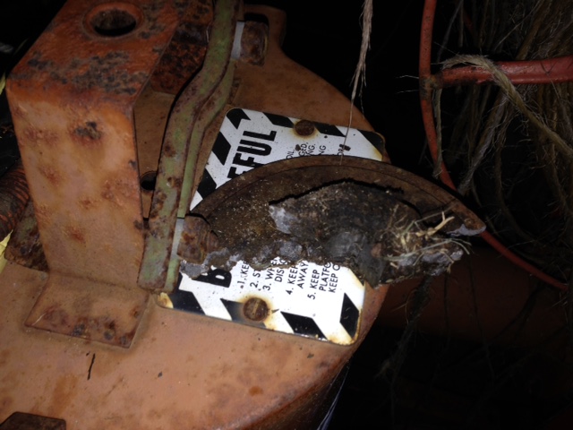

Ok, so I got the draw bar adjusted, the drive shaft adjusted, the whole package...then as I feathered the clutch she came to life...
After about ten minutes of checking linkage and re-greasing fittings, we fed her a little hay from a loose bail we had.
She did well at first, then as the bail grew larger, all the sudden bang...there goes a belt, then another, then the lower tensioner brake somehow broke the back plate.
Took 45 minutes to get the belts out, and another hour to figure out what broke...

Anyone have a good source for these random parts?

Let me apologize for forgetting to mention that you need to free the brake bands on the bale size adjustment.  They freeze after time as you said and can cause trouble.
Have to check my memory better.
Sorry!
As to parts I always suggest Sandy Lake.  They are one of the sponsors of this forum.

I might have what you need, but a part number would be very helpful.  Im not to familiar
to understand what that part looks like.  Is the spring broken too? Might have that as well.

I looked in the Roto manual, and it shows the entire brake assy disassembled but unfortunately does not list each part number. For reference, it is the inboard plate that covers the brake drum on the right hand end of the lower bar (the one that rides up the curve with teeth on it.
I would imagine there is a part number assigned to it in the service manual or parts manual, but that is separate from the "Owner/operator" manual. I have been searching for a service manual since this happened, but no luck. Maybe someone on here has a parts/service manual and can provide the reference?
I'm hoping to take it apart this week and when I do, I will take some good photo's for reference. In the mean time, if you have (think you have) the part, please let me know how much. If you can send a pic of what part you think you have, I can confirm it that way too.

No problem...Live and learn...so in the mean time, does anyone recognize the part description? Its the plate that keeps the guts of the brake inside the brake...(inboard side against the frame).

Yes, I should have that housing.     MACK

Mack PM's me and said he has the part. Thanks all for the info. I've still got to take the brake apart to see if the guts are chewed up. I'll add to this post when I get ready to run it again. In the mean time, does anyone have a source for belts, and any advice to go with putting them on and adjusting them?
