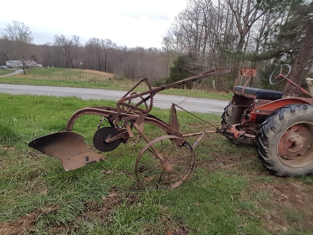

I just got my new to me #1 allis one 16in plow home yesterday. Lools like the wheel that runs in the furrow needs a little work. It has a pretty good amount of play in in and out motion. Just wondering if,anyone could give me some advice on how to go about fixing it. Ill have some pic little later. Il probably be looking for some parts to.

Most likely can unscrew the hub cap and add washers behind the lock ring. Make sure to grease the heck out of it.

I have one like that but it is real tight in the wheel, not much use I guess, I did take the lift side wheel off and clean up the lift so it worked properly. I wonder if the are some bushings in that hub, I don't know but thinking there might be.

like steelwheel said' i took some washers an titened it up an greased it good' it works fine.PS; nice little plow.Smile
