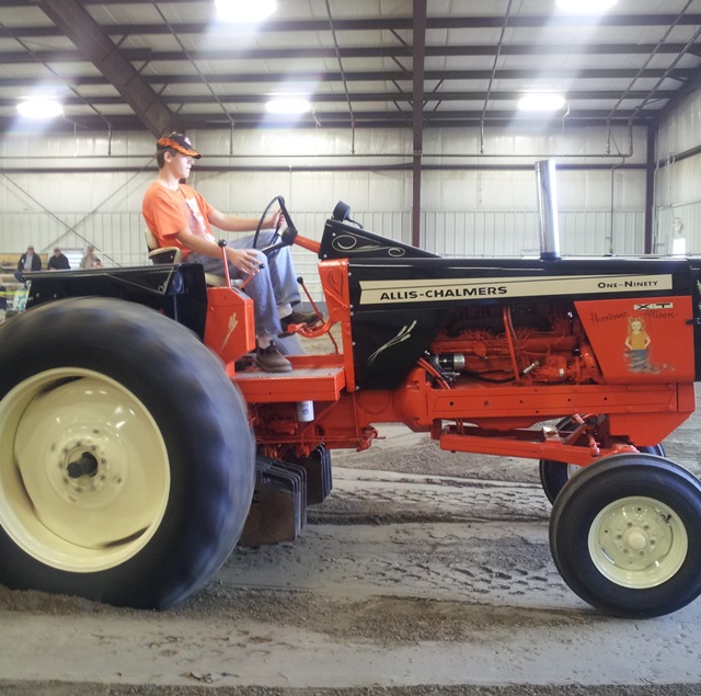

I am looking to source lighter weight rims for my 190. I don't know what I am looking for really.
What are these from? Is the center adapter something someone makes?
Charlie

Those centers are either clamp on or weld on. I tried the clamp on style and broke one the first. Time I pulled it. So I bought weld on from kenny's pulling parts and have been happy with them. There's also a guy that makes a wedge style but I don't know anything about them.
Points: 5271
Post Options Post Options   Thanks (0) Thanks(0)   Quote PaulB Quote  Post ReplyReply Direct Link To This Post Posted: 01 Sep 2016 at 7:29am
U Bolt type Clamp on hubs MUST be tightened correctly or they will break. I've known people to break cast hubs on very low HP tractors and I've had factory M Farmall hubs on a modified with more than 600 HP.  Many companies made hubs for duals, M&W and Urvenworth are just a couple.

Looks like a very standard 9 bolt dual hub to me.  Any salvage yard should have them laying around.

How's the correct way to tighten them?
Points: 5271
Post Options Post Options   Thanks (0) Thanks(0)   Quote PaulB Quote  Post ReplyReply Direct Link To This Post Posted: 02 Sep 2016 at 7:25am
Evenly and slowly, like a head. If you get one bolt ahead of another it will surely break the hub. It won't matter if you buy the top quality hubs or the basic OEM hubs, improper tightening is a recipe for disaster.
Points: 22756
Post Options Post Options   Thanks (0) Thanks(0)   Quote DrAllis Quote  Post ReplyReply Direct Link To This Post Posted: 02 Sep 2016 at 7:47am
And re-checking the torque after a couple of runs, not just assuming they will stay tight. Cleaning all the paint off of the axle is a good way to start.

There is also a difference in where the center disc is positioned on the rim when they weld it. Your top picture shows the disc more centered in the rim, while the lower picture is more to the outside. You generally want the tractor as narrow as possible for performance and hauling purposes.

Not to hijack a thread, but why is narrower better for performance?  Clearly less stress on the axles, but other than that...

The narrower your wheels are set the straighter it should go. It won't try to turn your tractor as much when one wheel starts slipping. Also its easier to fit on a trailer when the wheels are set in

Where did you find that top picture Charlie? That is my oldest son pulling in Moses Lake WA.

Post Options Post Options   Thanks (0) Thanks(0)   Quote Charlie175 Quote  Post ReplyReply Direct Link To This Post Posted: 07 Sep 2016 at 5:22am
waterstractor.com
Cool! I have some questions about the tractor if you don't mind?
