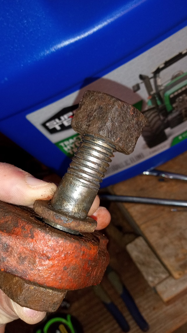

Yes, that's them. I'm guessing there's some special method for taking them out without warping the rim or damaging them? Like maybe taking the nuts off the back and popping them through?
The rim looks totally fine now. It is rusting and the valve stem has been leaking since before I bought it any time the tractor was parked with it at the bottom. That being said, the rim on the other side does look newer...or maybe just less rusted.

Basically, they take up any play between the wheel and the center. To remove, take a wrench, and hand turn till it gets tight, one way, then turn it the other way till it gets tight.  Sweet spot is half way between those 2 spots.  Hold it there and unscrew the nut, from behind.  Easiest way is to leave 'em alone, and remove the wheel center from the axle...Wink
Also, I think the longest leg of the cross marks where the cam is highest, IIRR.

Wire brush all the rust off and test fit the bolts into the Clamps... You will see that TWO of the bolts have cam lobes on them and when they TURN you push OUT on the clamp to wedge against the rim.... YOu turn and HOLD the bolt in place, then TIGHTEN the nuts...
Put one of the standard clamps on the tractor HUB at 12 o'clock..... roll the rim over and set it OVER the clamp so it is hanging on the hub..... Put the two LOBE SHAPE clamps at 3 o'clock and 6 o'clock... and the other STANDARD bolt at 9 o'clock
You can turn the two CAM BOLTS at 3 and 6 o'clock so they push OUT and tighten on the rim... then HOLD them and tighten the nuts... as Dave said, the CROSS on the bolt head shows you the HIGH spot of the CAM.

Two bolts on each side are eccentric style bolts. Dave is correct in that the longer leg of the cross indicates the high point of the eccentric. This longer leg points to the rim when tight. I needed two sockets to remove and install them whereas the other two were locked in to the clamps needing only one socket for removing and installing

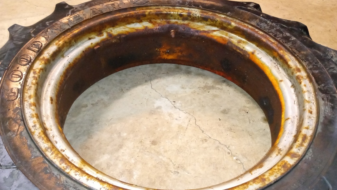

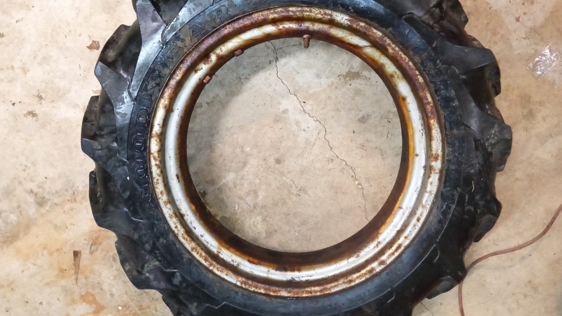

My situation:

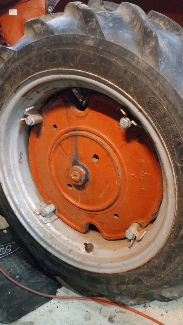

My other, good wheel:

I have a couple tractors with ORIGINAL rims and a couple with the new style LOOP rims... The LOOPS sure make things easier to install / remove / and keep tight ... Never have to worry about one slipping.. Seldom happens, but possible on the OLD design.

You mentioned there's CC in the wheels. Better inspect those rims real good. CC eats the rims up making them weak and dangerous especially at the bead. I see the one rim is pretty rusty. Make sure the inside of the wheel where the tube goes is nice and smooth so you don't ruin a tube with the rusty, and scale inside.
Steve@B&B
Good tip. I was just going to have a tire store do it. I don't know for sure what's in it. It's kind of a gross milky color. And the rim is rusty, so I assumed it was Calcium Chloride.
When you say dangerous...do you mean like a critical failure collapsing rim? Or just a bad bead seal and the tire comes off?
