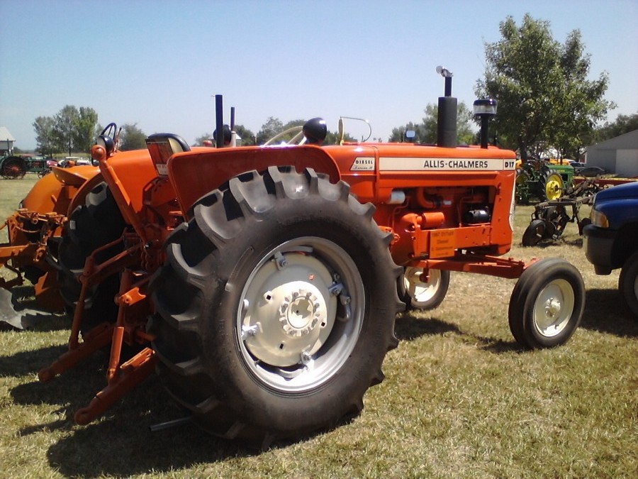

About 15 years ago, I got the Rims on my D17SIV powder coated silver.
by a local company for $80.  I had them sandblasted prior to the powder coating.
I didn't check into what it would've cost to have them galvanized, but I'd guess that it would have been at least that amount; plus, having to take them quite a ways to get that done.
I think these turned out great.  The guys that mounted the new tires were very careful not to chip the coating.
