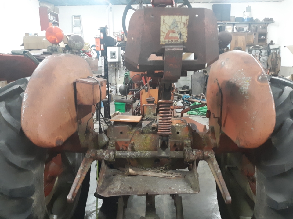

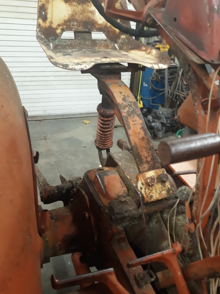

Couple photos of how the seat is relocated

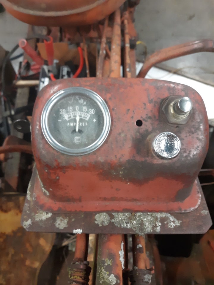

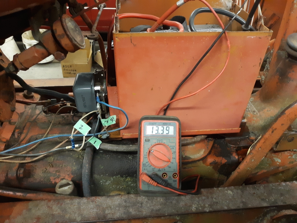

I went rogue and stayed with the existing charging system. The whole thing was converted to a 60s GM style with a totally farmricated wiring harness. Some of the materials look like stuff Dad was using at the time before he passed. The circuitry similar to a 170 wiring schematic. So, I had gotten an alternator earlier a d have subsequently replaced the external voltage regulator with a solid state type.
Yes, the harness is hardly presentable but as you can see the charging system is working

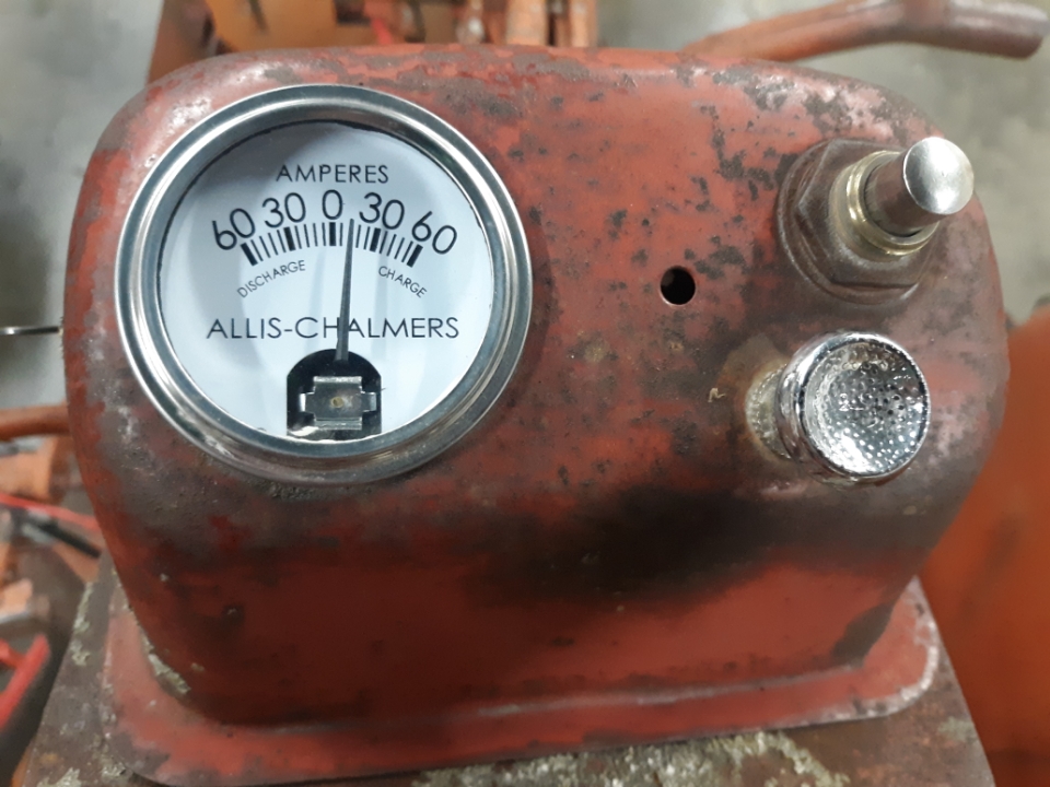

A new ammeter as recommended by DJs for this type conversion. Overkill? IDK, but again is working.
The old one didn't move at all. New light switch. The lights are mounted on the fenders but they work once I get a good ground. Only have one original style light which currently is not working.
