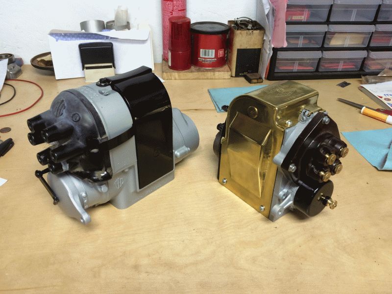

A friend told me I had to post this picture so here it is. I have been busy working on mags the past few weeks and just finished these two.  The one on the left is a IH model F6. It is for McCormick Deering WK40 that my cousin has. All it needed was a good cleaning , new condenser and bearings. The one on the right is a Dixie 46 which is for a Allis Chalmers 18-30. This one was rebuilt by different local rebuilder and didn't work so it came to me. It got new bearings, a good used set of rotor drive gears and a Good set of used points. Then I cleaned it up and did some polishing and clear coating on the brass. They both work as good as they look.  Matt

They look fantastic!  Nice work Matt.

They do look great! Keep doin' nice work like that Matt. We need more young guys for Mag men so when older guys like me retire there's still someone out there that will keep it going. Good job!

Matt, you not the same guy up there that makes battery hold downs for the D series?
You did a great job on that brass.

GREAT job Matt!!  They look better than new.....
