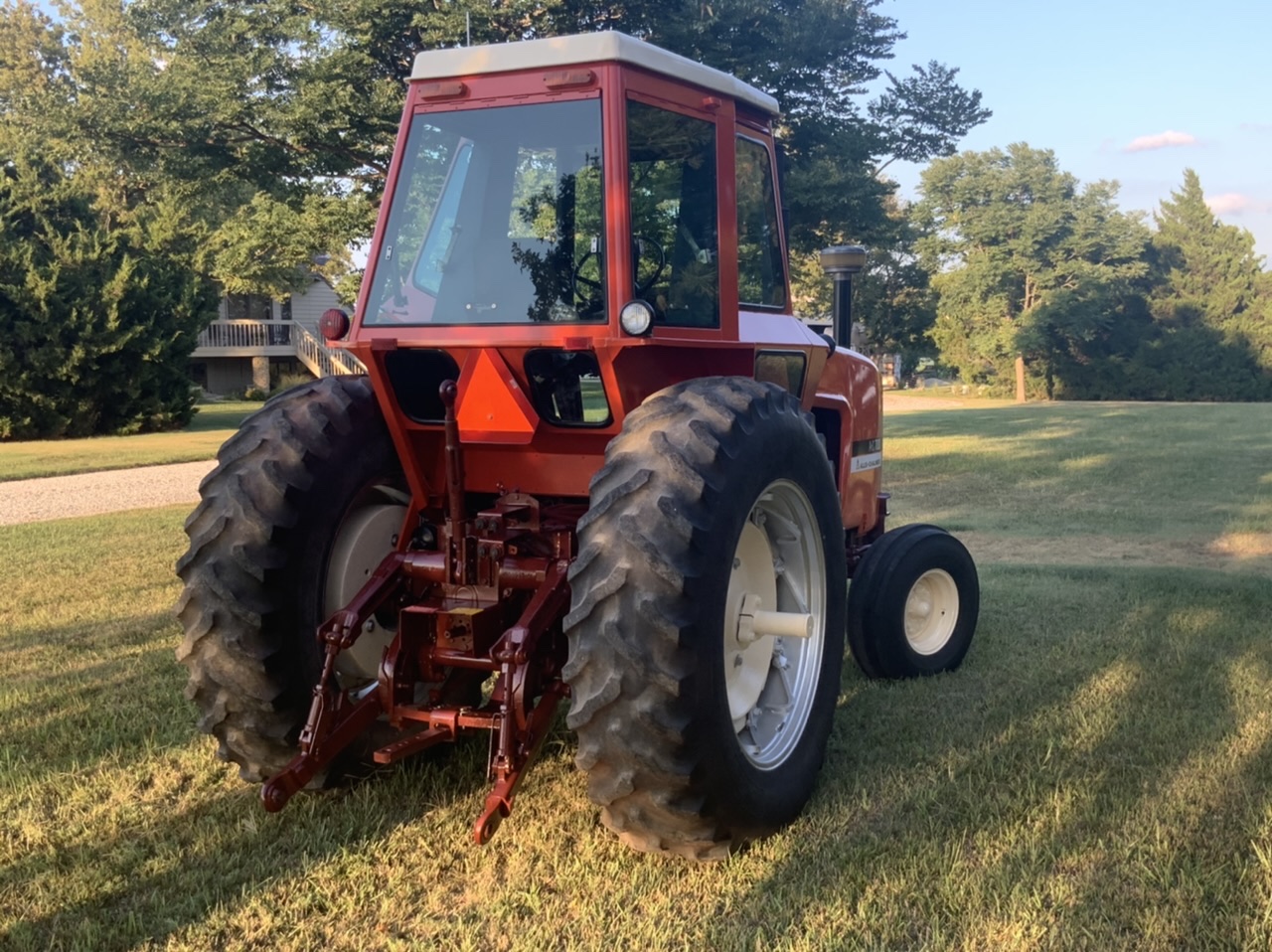

Iuploads/20613/1E4C3347-7454-4644-BADB-639B30E53BE1.jpeguploads/20613/10856E22-1187-45B8-A74C-BAE75CA6D262.jpeg
This has been my 6 month Covid project. This is a one owner tractor. The hood and grill are original paint. Black belly upholstery kit in the cab.

Awesome job ,looks great. Credit to you.👍👍

You did a nice job. I see you have a custom gas strut and bracket for opening the door. What did you use for the maroon paint.
  Tim

the door kit is from tomNE. It’s supposed to be mounted at top of door, but I didn’t like how it torqued the door, so I moved it mid door. The bracket I made to get the strut to work better. The paint used was ac Persian and ac maroon in rattle cans and lots of wet sanding before and between coats. The front axle was exchanged off our 7010 for loader work. The additional frame was the quick mount for the farmhand loader now used on my jd 7700. It benefited the tractor by eliminating the twisting that caused oil leaks. There is around 7400 hrs on the tractor. It had an preventive underhaul at 5000hrs. I appreciate all the kind comments.

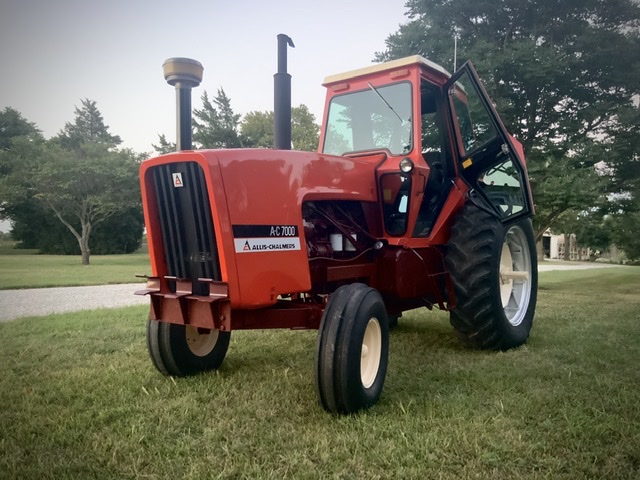

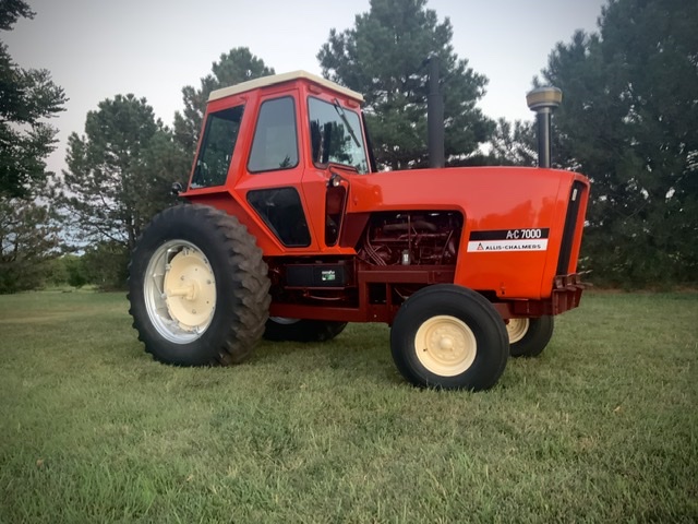

I think painting the front hub, wheel and lug bolts all the same color is tacky, but I tried to stay true to original.  If you see something wrong, please point it out.
Side note, I submitted this photo to orschelns 2021 calendar contest for antique and restored tractors. I figure anything over 35 yrs qualifies.

Matron Belly, That’s a great looking AC 7000! The maroon paint is a nice throwback to its AC era.

I don't want to sound critical because you've done a beautiful job!  The only thing I see not original is the rear axles should be black versus cream.  The front hubs look fine to me.

That is a possibility, as the color pic on the manual cover is long gone, so going off black and white pics. I appreciate constructive criticism.

It's a matter of opinion, other than shiny new lug nuts that's the way that the front wheel looked from the factory. I think if the hubs were burgundy (or orange on older models) it looks tacky, like the painter was too lazy the finish the job. Remember your tractor my opinion, tractor owner wins lol.
That said you did a heck of a job and have an outstanding tractor

You don’t think the lug nuts were painted?

You have it right,front hubs and bolts should be cream. The rear axle should also be cream on that series. Looks really good.

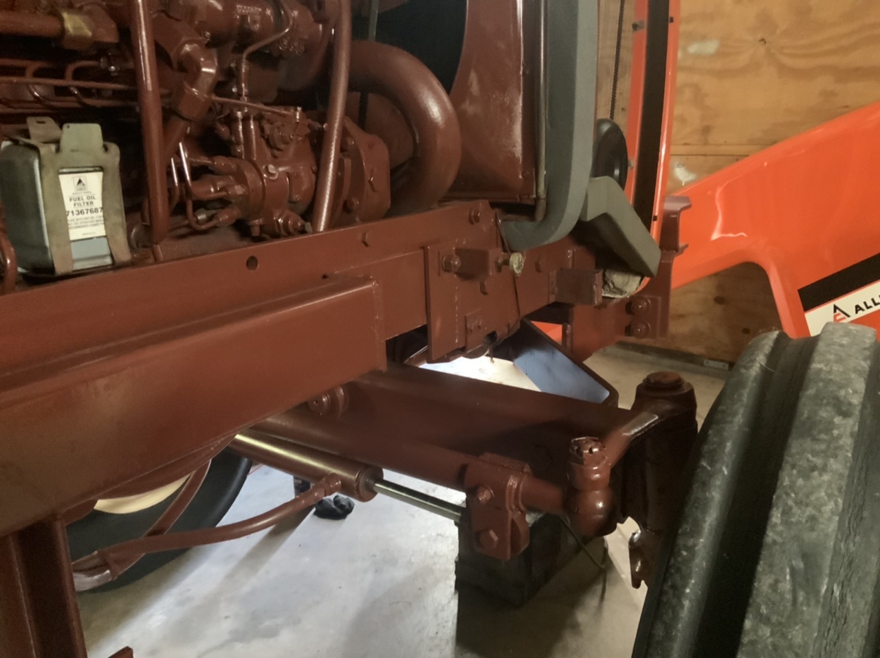

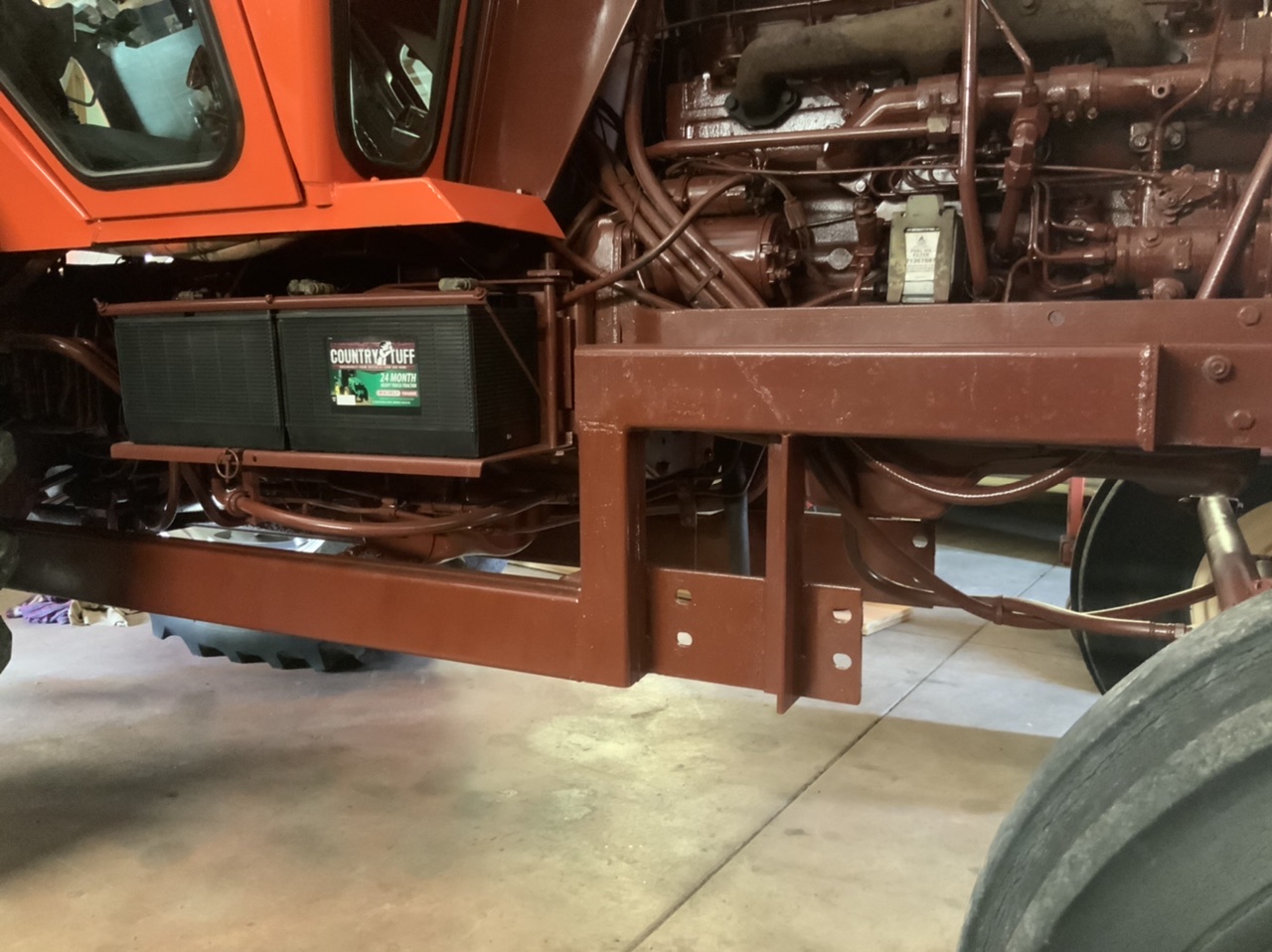

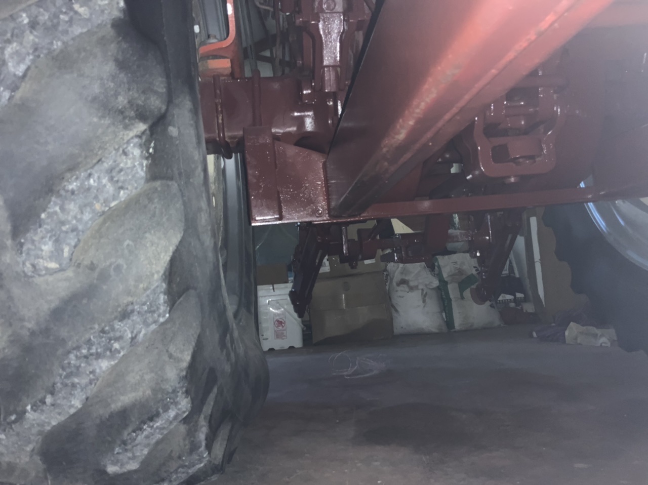

The reinforcement runs from the back axle (first pic) to the front of tractor to weight bracket (second pic). My loader mount takes place of weight bracket, but essentially same thing. Last pic shows center portion of framework.

According to my sales brochure on the "7000" tractor (Which is in pristine condition & in color) your paint is 100% correct in every aspect. If you have any interest in the brochure send me a "PM" with an address and I will send it to you. Your tractor looks GREAT !!!!

I've had 3 7060s and a 7080 none of the lug nuts were painted

I assume the hubs and rims were painted before they got to the assembly line

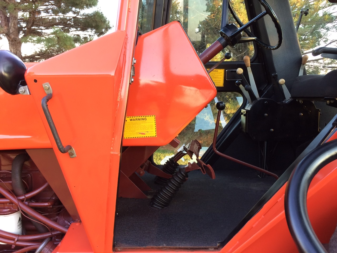

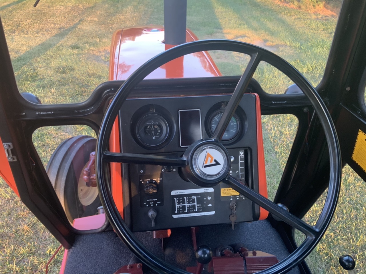

I thought I would add some pics of interior and rear end. uploads/20613/62BB52E6-743F-406A-AFCC-F0C341876E95.jpeg
