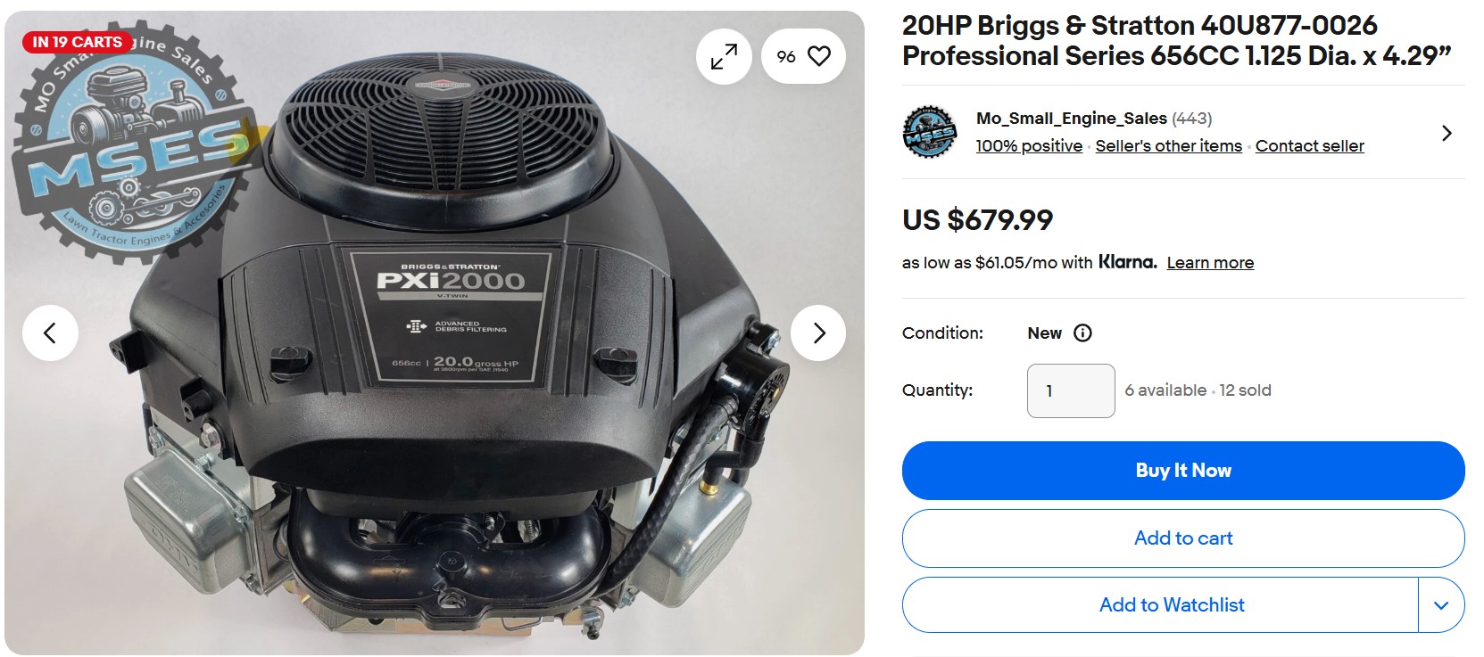

Post Options Post Options   Thanks (0) Thanks(0)   Quote steve(ill) Quote  Post ReplyReply Direct Link To This Post Posted: 58 minutes ago at 12:09am
here is another version... NOTE the shaft is 1-1/8 instead of 1 inch... so you have to VERIFY as they make a couple different sizes..
