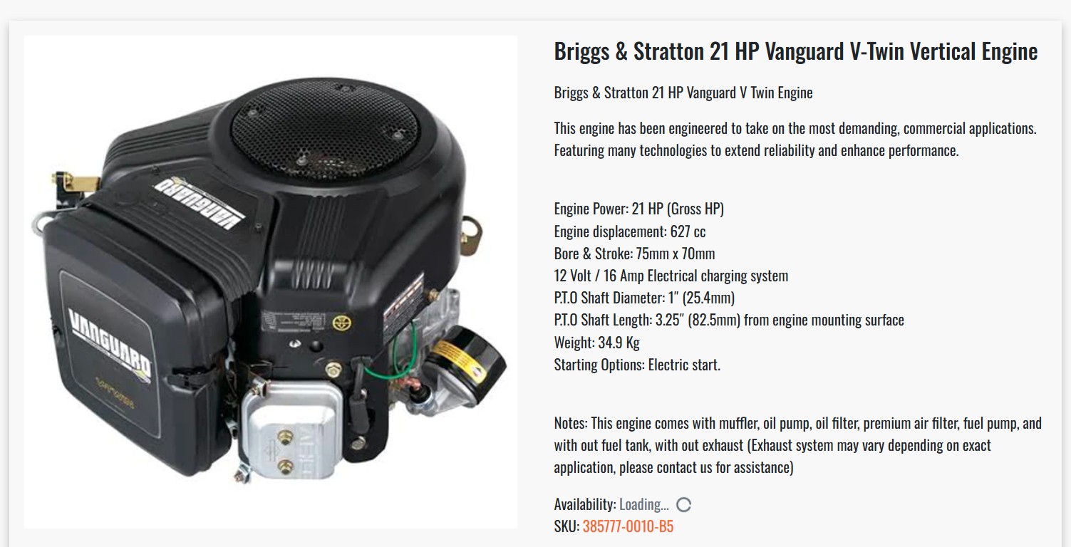

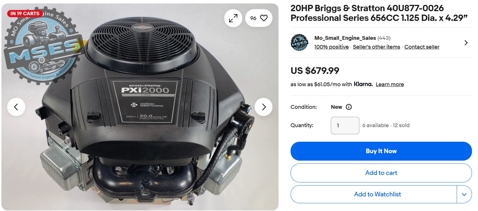

Assuming it's a  B&S , drop in a V-twin ! , they run smoother than the opposed, should fit fine.Wiring is the same.
LOTS of 'dead ' riders with vtrins in them for sale, anything from 16 to 24 HP will work for you.

Jay, Thanks for the reply, are you indicating that the crank shaft diameter and length are about all the same.  That is what has me befuddled.  Like I indicated fitment on the deck of the chassis and crank has me in a tissy.  Confused
