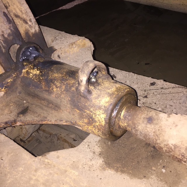

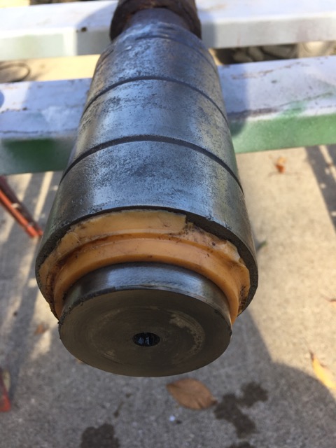

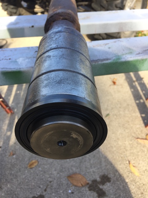

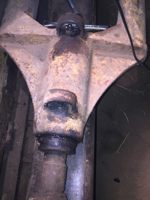

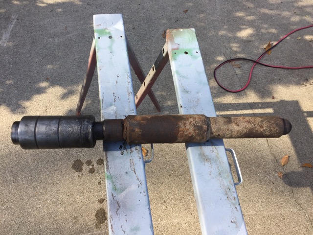

Some pics of my rebuild on my track tensioner. I got my seals from an old Agco dealer that took over an Allis Chalmers distributor.
One pic shows seal not holding and grease just pumping everywhere. One pic shows idler arm off unit. I had to re weld the rod as it was cracked. One pic shows wha the piston looks like out of unit and the new seal vs the old one. The old seal looked like it was an old plumbing gasket they put on.
