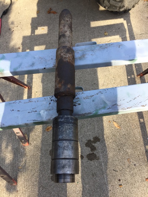

started a new post as the original one is a couple of months old. Had ordered 2 new seals for my hydraulic track adjusters. Had time this weekend to work on the right side which was blowing grease out and ram would not move. I had taken the entire idler yoke and adjuster out as a complete unit and was working to get the adjuster rod to separate from the ram. As you will see I gave up on that thinking why bother. I was able to pull the ram and rod out as a unit to replace the seal.

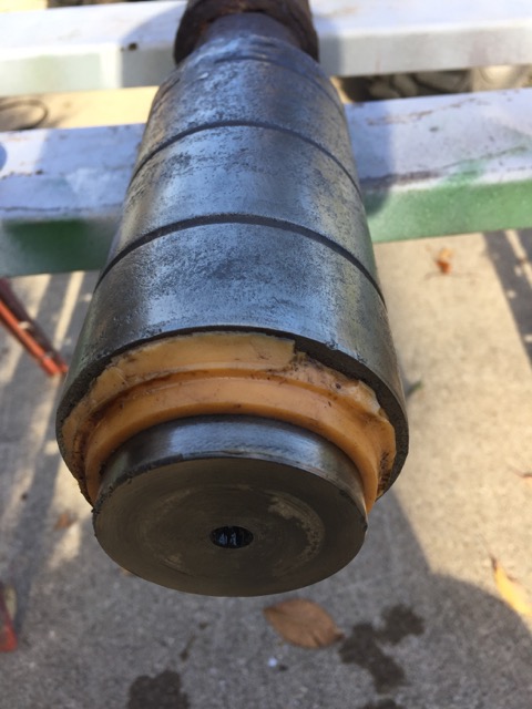

What a piece of cake that was. Seal us a solid hard rubber type compound and is flared. When I pulled out the ram the old seal remained in the bottom of the cavity but was easy to get out with flat piece of wood which allowed me to remover all the old grease as well.

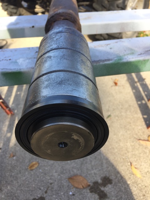

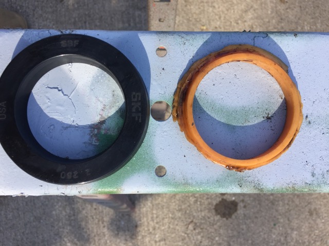

I swear the old seal is a standard 2" gasket from a plumbing tailpiece you can get at any hardware store. I is identical to one of those as you can see. The new gasket is shown next to the old one. Putting it in was easy. I turned the new gasket 90 degrees so it went in sidewise and cold be pushed to the bottom of the cylinder. Then is used a wooden dowel to push the gasket down flat in the bottom of the cavity. The Ram just slid in and rested on the gasket like it is supposed to. Working like a champ.

Forgot to mention that the pics are pre- polishing the ram and cylinder. I used wire wheel and emory cloth to polish. The cylinder was not pitted and in very good shape, the ram was very good up till the last inch. Polished up pretty good all in all. I know this is minor in the scope of work on a piece of equipment like this, however I am always pleased when something works out like this. Next is working on left side which is not leaking but idler is froze. Will be using a 10 ton porta power on it in conjunction with the adjuster. I can also use a chain and come along off the blade to help move the idler wheel assembly to get it moving. Not worried on this one.

Been a few weeks since this post but forgot to ask this question. On the piston shown in the pics, the grooves on the piston,, are they for O rings to ack as secondary seals?
Would make sense. No parts manual shows that so I wanted to ask.
