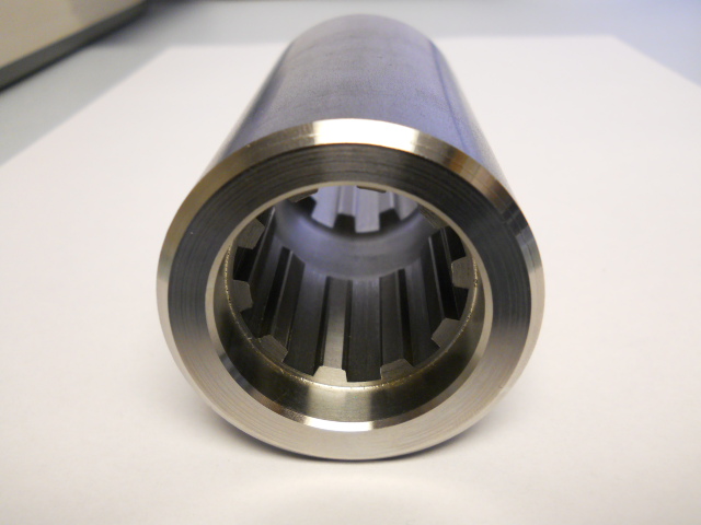

This will eliminate your slipping hand clutch, $58.00 delivered to your door.
Larry(OH) View Drop Down
Location: Shreve Ohio
Points: 1580
Post Options Post Options   Thanks (0) Thanks(0)   Quote Larry(OH) Quote  Post ReplyReply Direct Link To This Post Posted: 05 May 2015 at 4:06pm
Bought one of these and they are TOP NOTCH and very well built!
