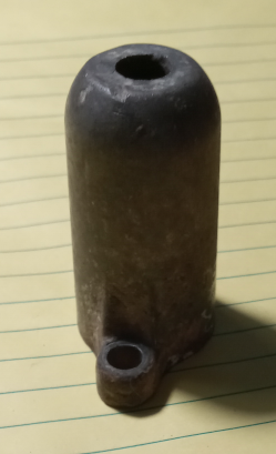

Just an update. After getting advice on this forum I removed the spool valve for the main lift on my AC-185. I now see that my main leak was coming from the fact that the rear spool valve cover had one of the ear broken off on it so that it wasn't tight enough and fluid was leaking out of the o-ring on the back.
Does anyone know where one might get one or two of these spool valve covers?
I've tried AllState and Bowman's but have not heard back from them.

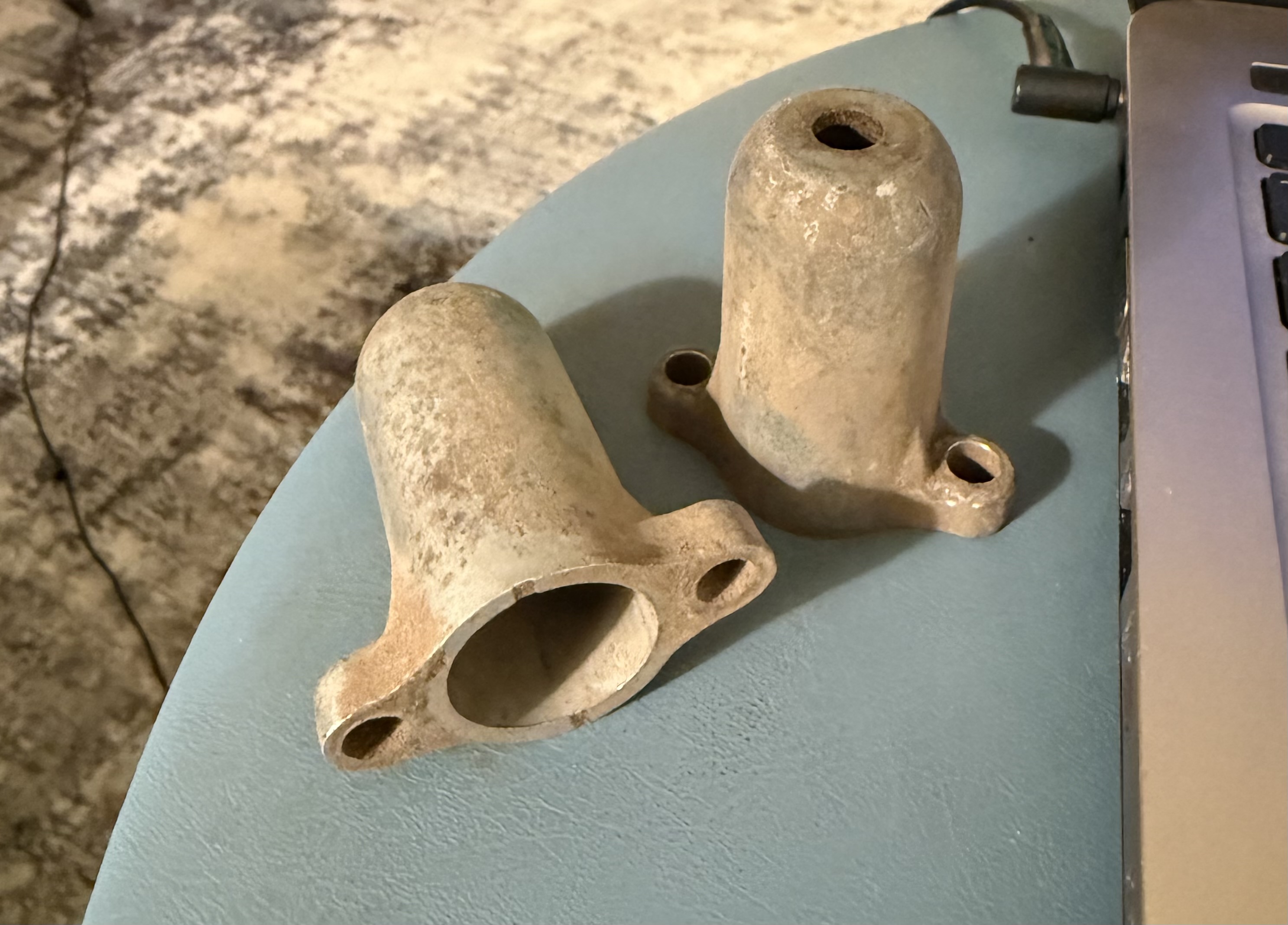

We need to talk. I think I have two of them.

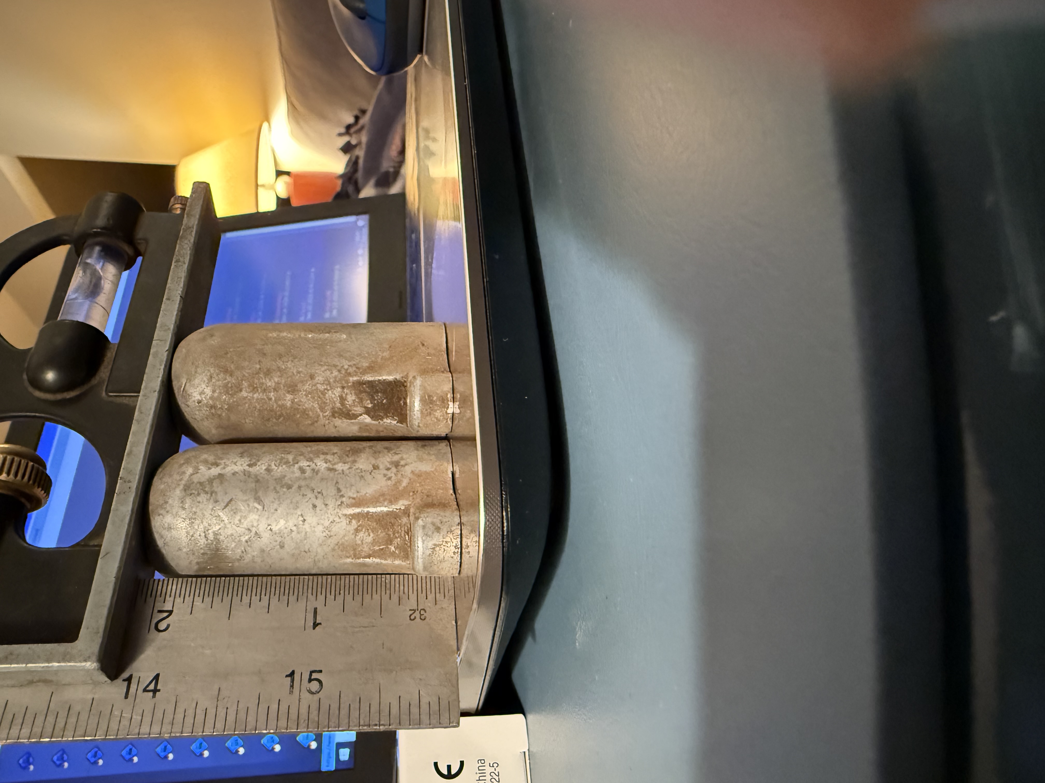

I'll buy both from you if you do. The Agco one in like $54! And then they will want a ridiculous shipping charge.

Thanks, those appear to be the correct caps. The main hole opening is about 7/8 " diameter and the two screw holes roughly 1.5" to 1 5/8 " apart. So how can I get them from you?
