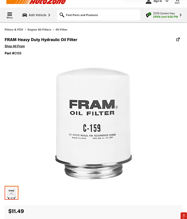

as much as I don’t like them, at least they’re just down the road and still quite reasonable!
