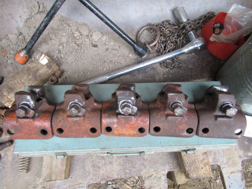

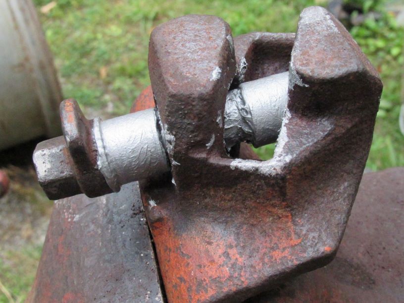

Had a flat tire on the D-17 and the wheel (including all the  clamps) were in bad shape so I decided to fix up a new wheel. First thing was getting a set of clamps back in shape. Lots of hammering on the cam pin back and forth with lots of PB Blaster to get them all loosened up. Then, use lots of "Never-Seize" to keep them free for a few years hopefully.

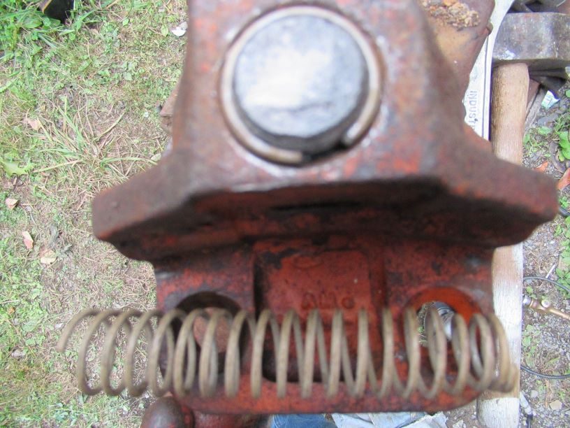

I was able to salvage all the snap rings but one. I really lucked out here.......found a spring in my 50 odd year collection that happened to have the right diameter and wire size.

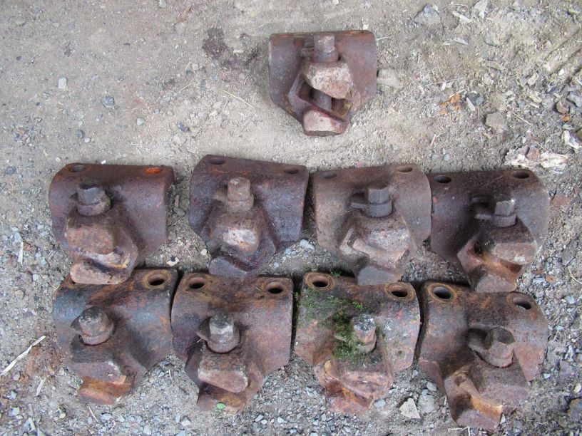

I was able to get five working well. I still have 9 left in this batch......one may still be salvageable and eight that are beyond "redemption".

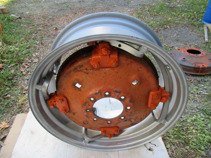

However, I did paint up four of them and mount them on my new $150 wheel.
Now, I've got to put together another set to fit my other $150 wheel and I'll be in good shape.

I consider myself lucky in that I found just one coil spring in my 50 year collection that had the correct diameter and wire size......I'll get quite a few more "snap rings" at essentially no cost.

x2 on what Bob-Maine said. I clamp them in my vise, heat them with a MAP torch, apply lots of WD40, remove the retainer, put my trusty electric impact wrench to work trying to spin the eccentric pin, and drive on the back end of the pin with my equally trusty hammer. Rinse and repeat....usually a number of times. After a bit the pin starts to rotate and then comes out. After that it's clean up, paint and Never Seize!

Word of warning,,,,,,,,,,,DO NOT get anti-seize on the face of the block.  I learned the hard way.
