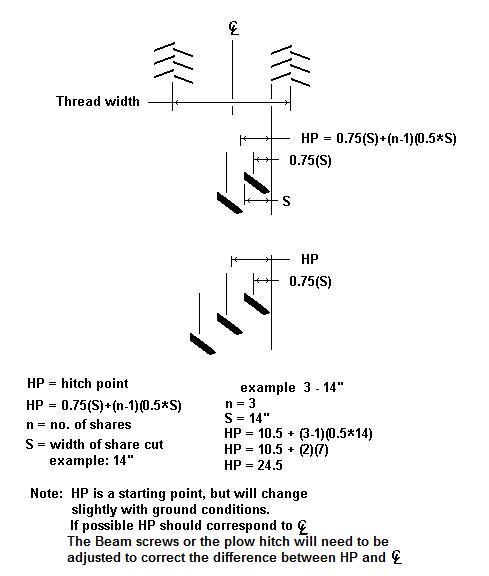

Ok see if i can explain this measure from the center of the hitch on the plow to leading edge of the front point and land side add 16 " to that measurment because you said 4 16 s and thats what BOTH rear wheels need to be set at that from the center of the tractor to the inside edge of the tires front and back

Its nicest if the center of the plow is aligned with the center of the tractor. That requires the inside sidewall of the right tires to be 32" from the tractor center. And for symmetry the left tires that same distance to the left. Then if the two rears have the same traction the tractor pulls straight. But usually the furrow tire grips better than the tire on the stover and that makes the centering less critical. It handy that the furrow wall absorbs the side thrust of the front wheel.
Its more important that the center of the plow be 32" from the inside sidewall so the front bottom cuts its rated 16" width.
Plow center to the left of the tractor center adds to the side thrust of the front wheels. Its probably better if the plow center is a bit to the right of the tractor center so straighten the tractor thrust. Locking the differential makes centering the load far less critical.

Bol- The 32 will work but is usually what is used for a 14" bottom.  The basic starting point is 36 and will need to be adjusted pending on bottom type and ground conditions.

   Al is correct. Inside of furrow tire to tractor center point should be 36 inches for a 4-16" plow.

That 4" right of center would balance some of the unbalanced traction.
When I first pulled my AC 4x18 2000 monoframe plow with my 4020 I probably had the 18.4-34s on 60" centers and so about 42" sidewall to side wall. The hitch on the 2000 is very adjustable so I just pulled it as is. 11" off center. Differential look took care of nearly all side thrust and is handy on the 4020, released by tapping a brake pedal.
After I found the front wheels in the air in my damper ground I quit plowing for the day, added all the front weights I had, and took the front bottom off and moved the hitch to move the plow frame to the right 16" so then my thrust was more to the right but the differential lock still took care of it. I soon added a ROPS and that limited the wheels to 64" centers or 46" between them so the tractor center was 23" from the tire side wall, but the plow center was 27" over. I plowed more ground and did a better job with 5.5 mph and 3x16 than I did at 3.3 mph and 4x16 so I left it that way. Haven't plowed in probably 8 years, went no till.

I just always figured 1 and a half times the width of a bottom plus maybe a couple of inches for steerage slop amd it seemed to work!
