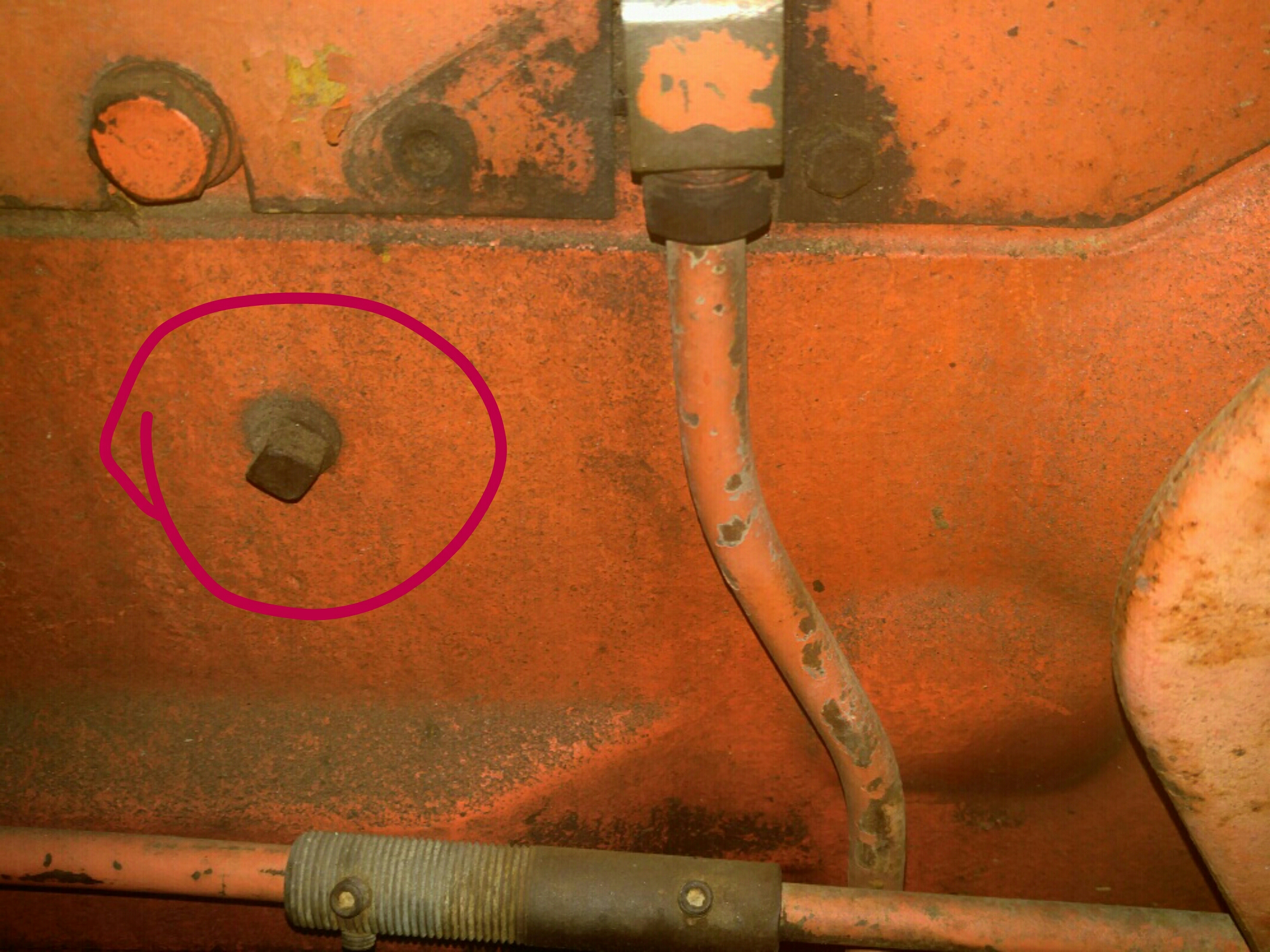

Post Options Post Options   Thanks (0) Thanks(0)   Quote Valkman Quote  Post ReplyReply Direct Link To This Post Posted: 16 Sep 2018 at 8:44am

Post Options Post Options   Thanks (1) Thanks(1)   Quote DrAllis Quote  Post ReplyReply Direct Link To This Post Posted: 16 Sep 2018 at 6:35pm
Not the original style, but yes that is the correct location and it is pipe thread.
