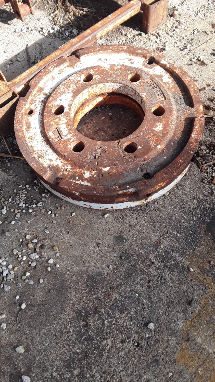

How much could inner weights for 38 inch castings weigh?
Points: 8429
Post Options Post Options   Thanks (0) Thanks(0)   Quote DougG Quote  Post ReplyReply Direct Link To This Post Posted: 17 Dec 2020 at 6:30pm
Ive  heard 1400 lbs,,, those are monsters, sorry thought they were the big dudes,, pictures were hard to tell,

I think these are 2 maybe 3 inches thick, and 31 inches wide

Post Options Post Options   Thanks (0) Thanks(0)   Quote jaybmiller Quote  Post ReplyReply Direct Link To This Post Posted: 17 Dec 2020 at 7:20pm
cast weighs about .284#/cu in or 491#/cu ft
so...
figure out the volume of the weight..
measure then subtract 'hole' from total..
 all I know is my back hurts just LOOKING at them !
Points: 22821
Post Options Post Options   Thanks (0) Thanks(0)   Quote DrAllis Quote  Post ReplyReply Direct Link To This Post Posted: 17 Dec 2020 at 7:26pm
400 lbs each.

I think that is the same weight I had on my D21, had three on each side, when I traded for 7030 the dealer took them off and put 2 on each side of that.  Dr knows but my dealer called them 450 lbs.
