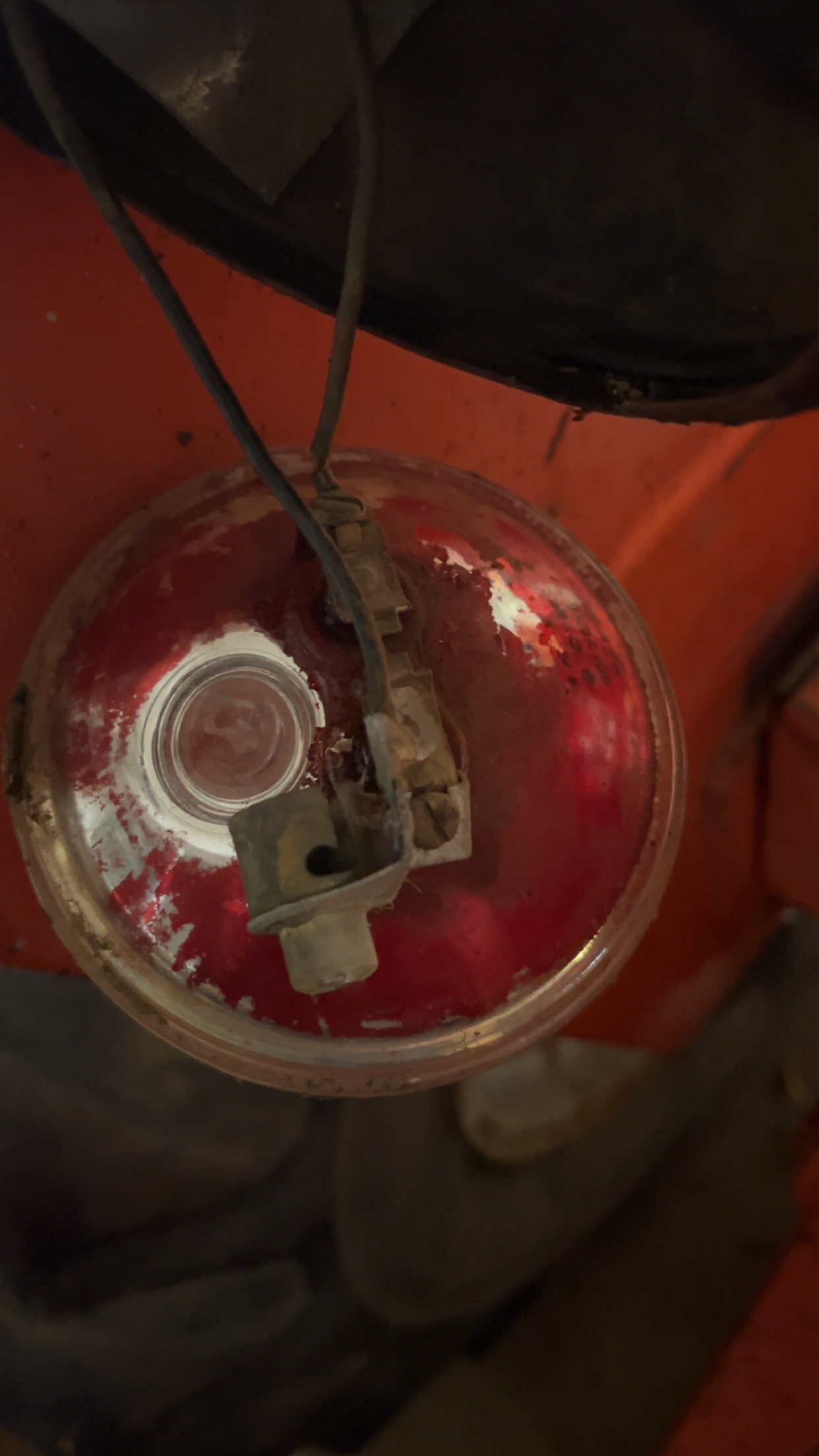

   New to me 180, trying to figure out the rear combination light. It has the spot for the small 12v bulb it looks like, but no lead for that bulb. Does it use a bulb and lead wire like the dash lights do? The one on the tractor is a 4428. But what I find online looks like it should be a 4409? I’ll try to attach a pic of it
  Also, has anyone done LED replacement bulbs for the front work lights? I’m not sure if I want to keep it original or make it functional IMG_4294.jpegIMG_4294_2025-11-03_07-15-05.jpeg  |

   This one is single wire

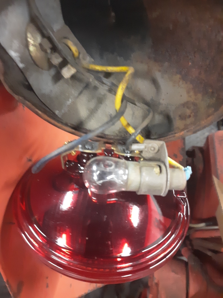

   Pretty sure it should be 2 wires. One field work, one for road lights
  4409 is the sealed beam field light. This is my 170 HTH

   That would make more sense. They have some of the wiring messed up it seems. The fender flashers are on with all three light settings

   On my 190, the flasher comes on with each light setting…low beam and high beam. Also the rear red light. The 3rd click is high beam and rear work light only. No flasher or red light in that position.
