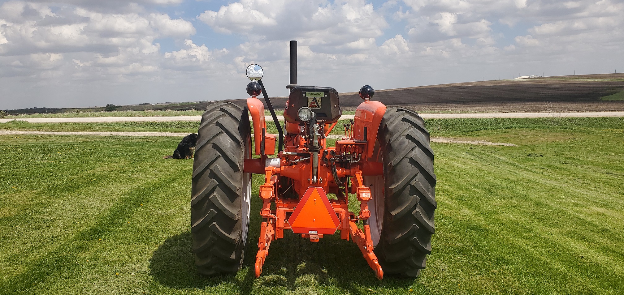

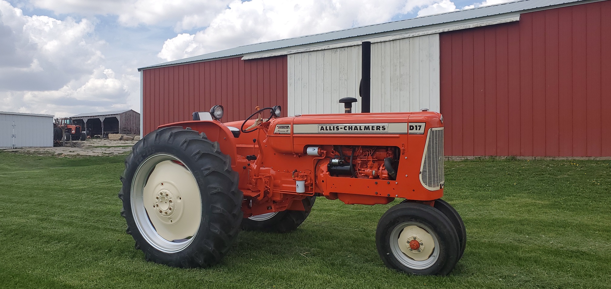

Looking good, really like the decals. Did you or the Dr paint it?
Points: 5340
Post Options Post Options   Thanks (0) Thanks(0)   Quote AC720Man Quote  Post ReplyReply Direct Link To This Post Posted: 02 May 2021 at 9:04pm

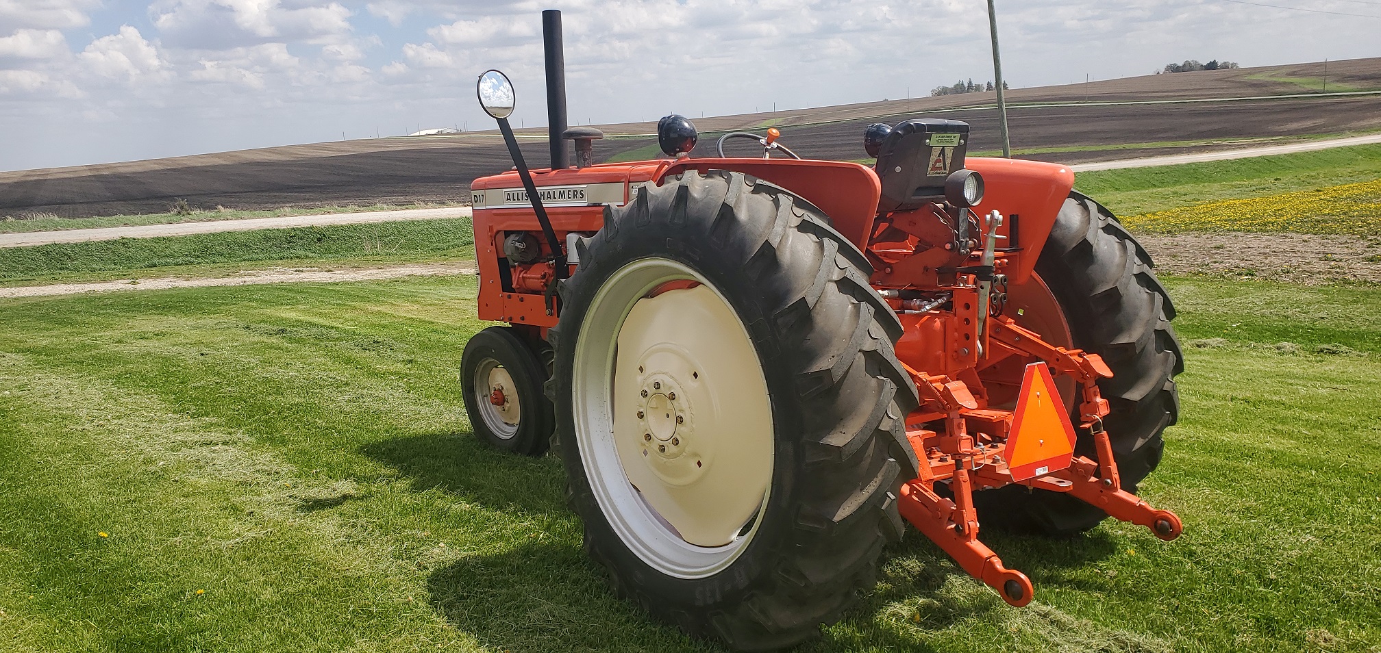

Turned out really good Doc. Those fender wheels sure are full of rubber!
Points: 8780
Post Options Post Options   Thanks (0) Thanks(0)   Quote SteveM C/IL Quote  Post ReplyReply Direct Link To This Post Posted: 02 May 2021 at 9:46pm
Whoever did it they did very well! Can't imagine Doc having the time. Tall rubber and high rpm 433. I'll be it moves on down the road!
Points: 22413
Post Options Post Options   Thanks (0) Thanks(0)   Quote DrAllis Quote  Post ReplyReply Direct Link To This Post Posted: 02 May 2021 at 9:58pm
Top speed of right at 20 MPH with the 15.5 x 38 tires. I started the sheetmetal work in December and am just now getting near the end. I still have to sandblast and go thru the seat suspension and install a new shock absorber yet. Then, wire the lights and I think I'm done. Those decals really set it off !!

Nice and a nice mirror. I need about 6 of those.

Post Options Post Options   Thanks (0) Thanks(0)   Quote AC7060IL Quote  Post ReplyReply Direct Link To This Post Posted: 03 May 2021 at 4:43am

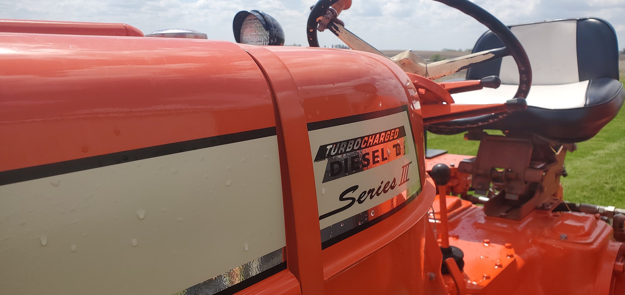

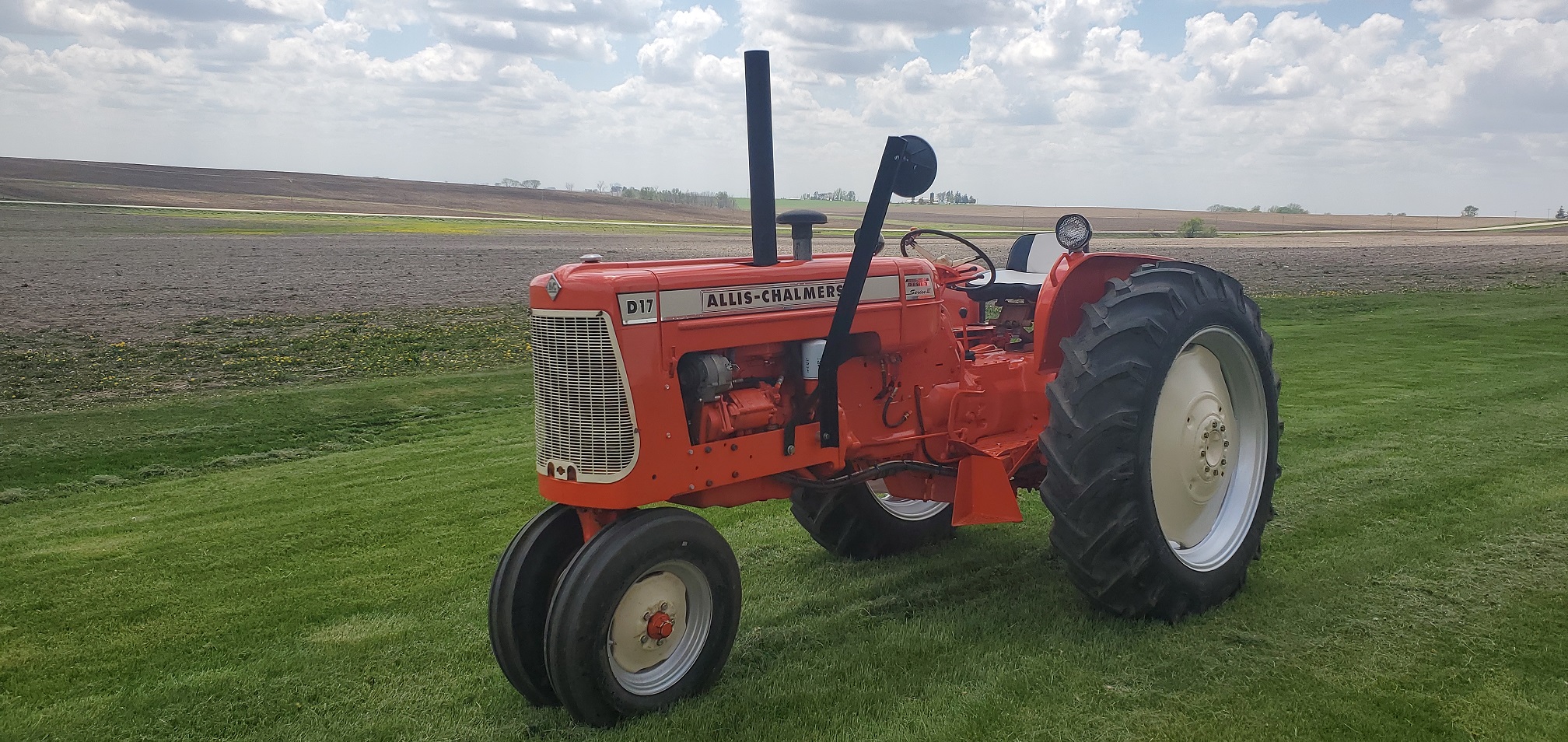

DrAllis, It’s a one of a kind and looks fantastic! I love it’s D-19 “Turbocharged Diesel” decal - nice era touch.
It’s new tall rear tires will be riding much smoother than it’s old 28s and will be pulling better too. I’m guessing they’re old 9-bolt 15.5-38s that you maybe converted to 8-bolt? If so, great job.
So you’re opting to loose it’s shade canopy?
Have you dynoed it yet?

Post Options Post Options   Thanks (0) Thanks(0)   Quote DrAllis Quote  Post ReplyReply Direct Link To This Post Posted: 03 May 2021 at 5:54am
The golf cart roof needs to get the framework painted yet, but it will get used for sure painted or not. Those hot sunny days are much nicer when in the shade.  Yes, it has been dyno'd.  85 HP @ 2300 RPM and if I slow it down to 1650 RPM (pto speed) it still has 67 HP, which is up from the 53 HP of the old gas engine. Rear wheels are old 9-bolt style that I welded in 8 bolt centers. Used to be an old set of tractor pulling wheels. Offset is just flush on the outside edge of the rim lip.

The post Doc put up about the build needs to be archived. The 2 separate hyd systems and how he made the "hitches" work together/functional is quite intriguing. Always wanted to put that engine in the 45D skeleton I have.
