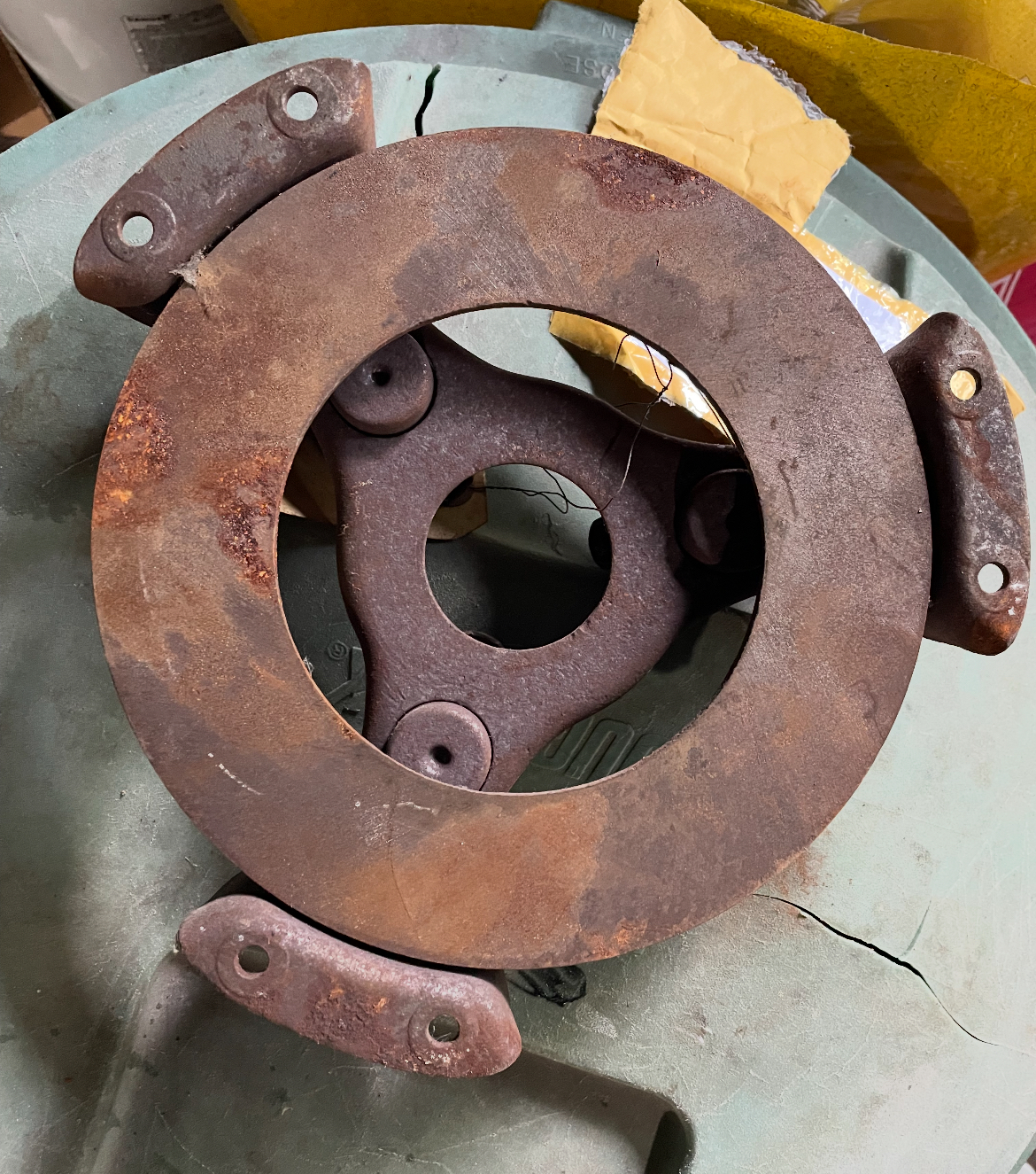

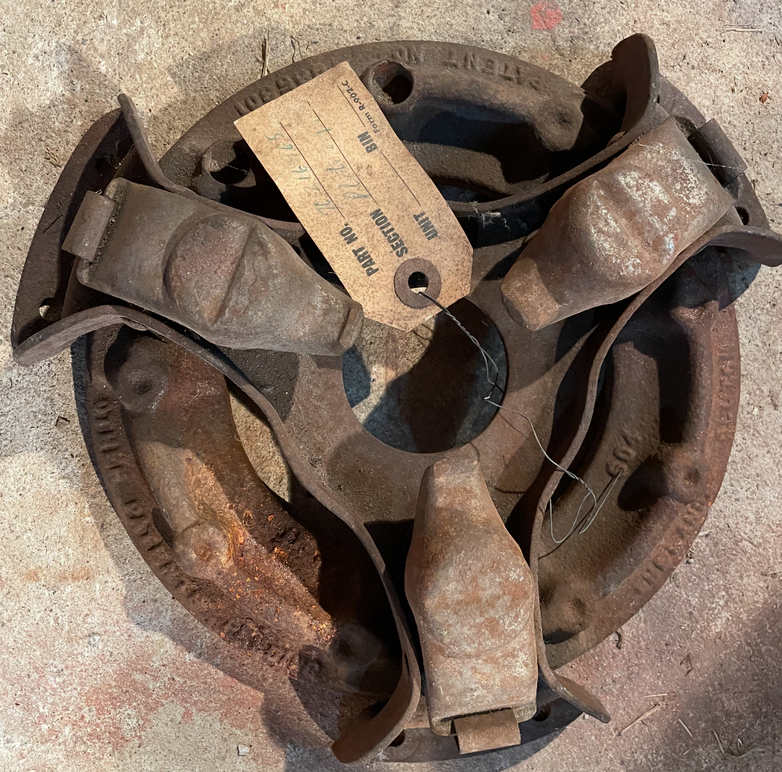

Post Options Post Options   Thanks (0) Thanks(0)   Quote 55allis Quote  Post ReplyReply Direct Link To This Post Posted: 20 hours 19 minutes ago at 8:54am
Here is the RC one…
The part number on the tag comes up as a for a C….

Post Options Post Options   Thanks (0) Thanks(0)   Quote PaulB Quote  Post ReplyReply Direct Link To This Post Posted: 14 hours 51 minutes ago at 2:22pm
Is that number 70216965?  the parts book shows that number to be a Rockford pressure plate not the Auburn pressure you have pictured. What is the diameter of the driving surface?
