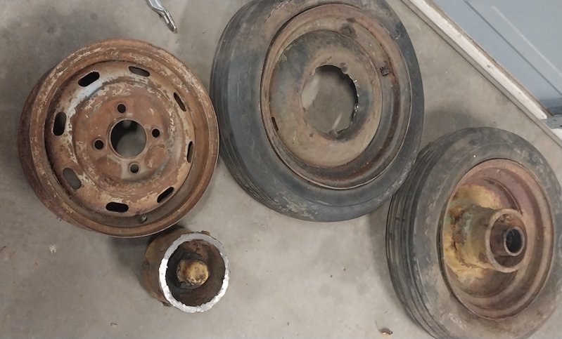

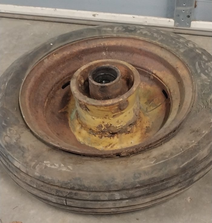

The derelict Model C mentioned above is now in the shop; I am working on the front wheels, they appear to be steel spoked wheels that someone cut off the rims and welded rubber tire rims on them. They are rusted through so I intend to weld some better rims on.
