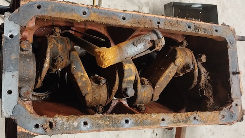

Bottom View

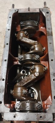

I am setting the blower engine aside for now and focusing on the Model 60 combine engine as it is in MUCH better condition.
Combine bottom view:
Everything looks so good I am not even going to remove the bearing caps.

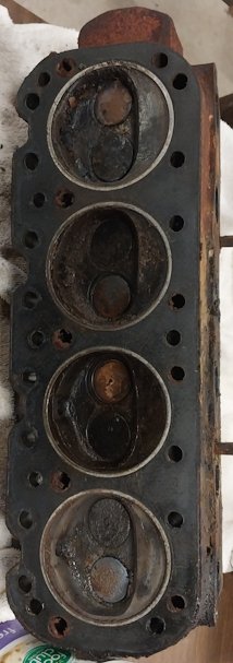

Combine head:
A basic cleanup and valve job should suffice.

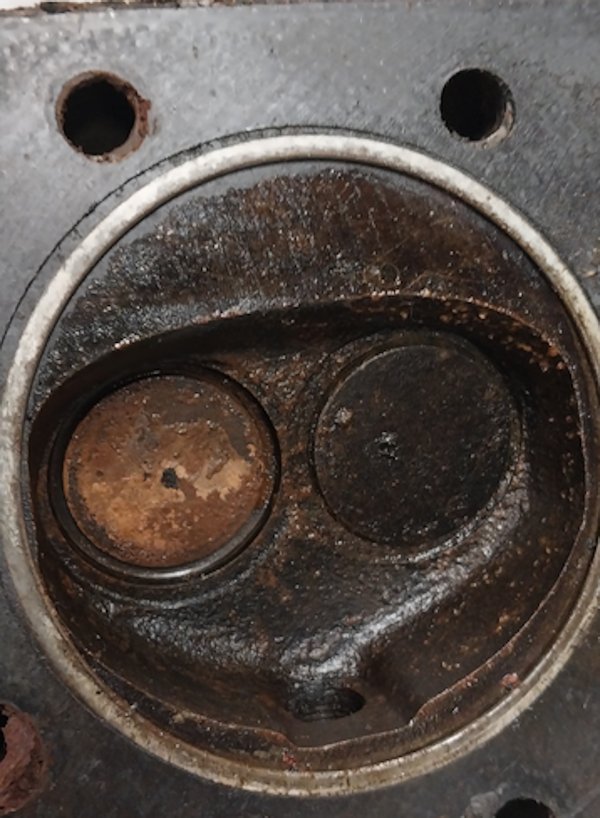

Combine Head #3 Cylinder:
The intake valve seat has been re-worked and machined into the head somewhat deeper, maybe 1/16" or so. Not easy to see in the photo.
I am not going to stress over it.
