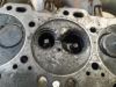

Curtis, my son, was running in beans, he called and said "Dude, I think I just blew a head gasket." He said lost power instantly and saw white smoke out the exhaust. Shut her down. I will say he is very good at diagnosis for his age. After removal of the valve cover we knew it was bad, #3 exhaust valve was broke. Remove head, piston beat to death with top of valve broke off also..

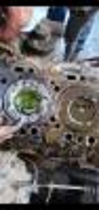

any pics of the carnage?

Thanks everyone, Dad is supposed to get a pacemaker on Tuesday. Hopefully that does the trick. I'll try to post pics but don't know what size they may be from my phone to email to here. It is ugly. Viewer discretion is advised...

I wonder what would cause that? Had valve set been adjusted recently? Sometimes that helps. Or maybe just fatigue on old parts.
   All valves are two piece, fuse welded in the stem.

    I will say, earlier in the season the serpentine belt tensioner bearing gave up. As Curtis was dumping the grain he said, " My hyd oil temp light is on and volt meter is down. I got in the cab and the temp gauge was in the red. Shut it down and replaced tensioner. It  started and ran fine. I honestly don't know if that was the cause of failure.
       Our neighbor said he saw Curtis pull into the field and saw white smoke out the exhaust but couldn't get to him in time to let him know. So the engine was pushing water through the exhaust for at least 10 minutes prior to failure, so my question is, what happened first? No way a valve can rattle around for 10 minutes, head gasket failure? Injector? Or damage from the overheating problem 100 hours ago.? Curtis did say it was running fine and then in 2 second's lost power and he said he couldn't shut it down fast enough.

May never know the answer to that. Could head gasket fail and let water in cylinder and exiting through hot exhaust valve cause valve to pop off?

White smoke doesn't mean water. Without smelling the smoke it could have just been unburnt fuel. Bent valve would cause no compression and white smoke. Hard to say at this point.
