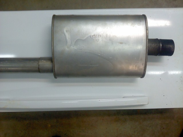

I put on a Walker 18101 universal replacement muffler, and wow, is this thing great!  It is quiet, but the D17 still sounds like a tractor.  I bushogged 5 acres today, and didn't need earplugs, and the 17 had all the power she had before.  I painted the muffler with hi temp paint.  I was going to put an extension on the outlet, but liked the height just as it was and just stuck the raincap on it.
The muffler is a 18101.  The dimensions are 4.5"X9", and as you can see, it fits perfectly.  The 18102 is a bit shorter body.  I got mine from a local Parts Plus store for $42.  However, NAPA had the same part #, as did most auto stores.  As for flow through,  it crosses with a 67 Thunderbird with a 428, so I think it can handle the flow of the Allis just fine.
This is definitely the way to go.  It just transformed the Allis from a tinny loud pain, to a modern, quiet tractor I can run at full rated speed without having to cover my ears.

The 18101 does not have the domed top does it? If it sits outside it will hold water on the top or worse funnel it into the engine if their is a pinhole.
AllisUpstate View Drop Down
Joined: 06 May 2011
Location: Upstate NY
Points: 1261
Post Options Post Options   Thanks (0) Thanks(0)   Quote AllisUpstate Quote  Post ReplyReply Direct Link To This Post Posted: 06 Aug 2012 at 12:14pm
Nathan,
Yes it does have a flat top and the crimped seam, so the top will hold water.  I plugged the pinhole with a stainless screw before painting it, so no water will leak down if I leave it outside.  Unless I have to, I don't store any of the tractors outside, but even so, it won't get any water down.  Plus, since it isn't a straight through design, I don't think any small amount of water would find its way down to the manifold.
It's not a perfect solution, but for $40, it sounds great and is a perfect fit into the oval of the hood cutout, and it's a heck of a lot better than the Stanley I took off.
