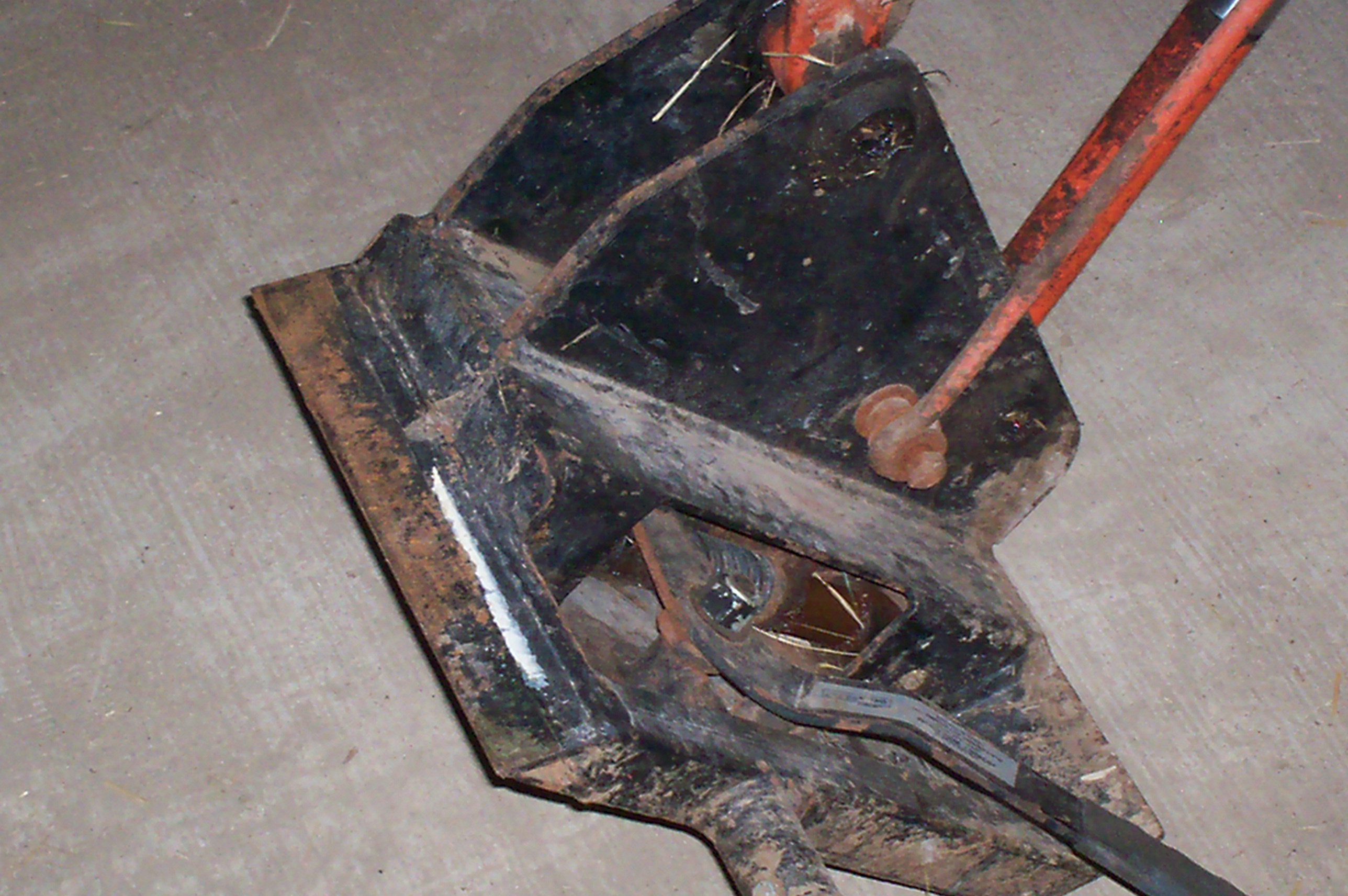

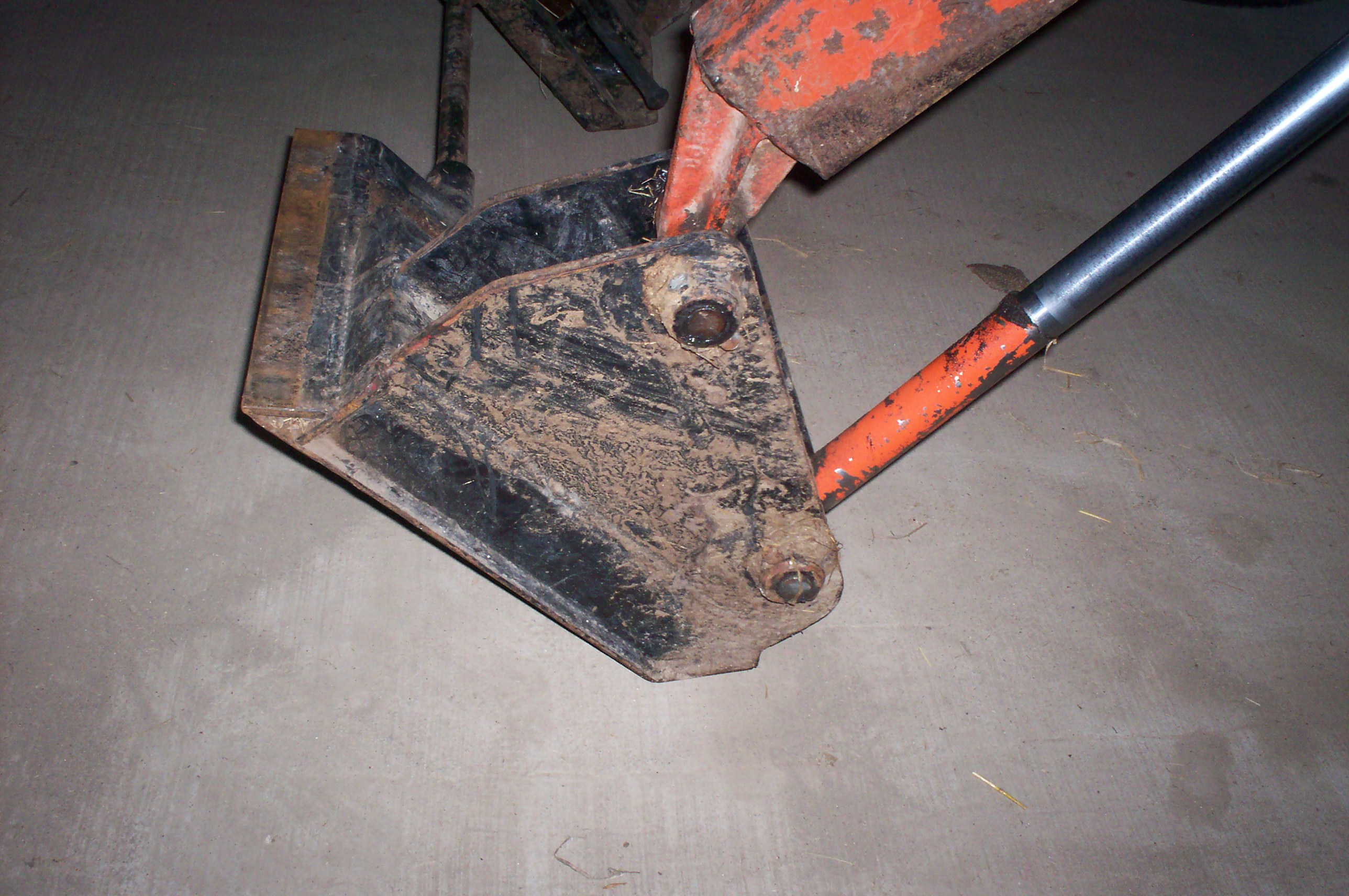

Tracy, if you are looking for quick attach for the bucket and spear, I have a unit from HLA that I bought through my implement dealer.  It is made in Canada by Horst Welding.  Here is a couple of pictures for you.  This first picture is of the outside.
This next picture is of the inside and shows the attaching lever.  It is the same as what a skid steer uses.
I don't see how I ever did without it.  It was well spent money.  PM me if you have any other questions.
