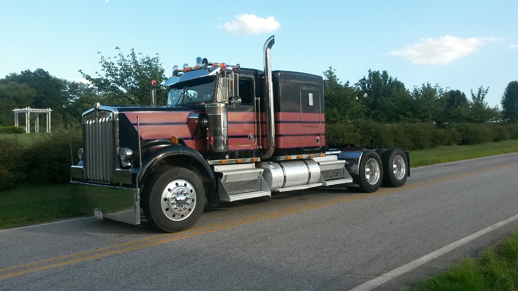

I have a 1987 twin screw Kenworth W900 with a 40ft flatbed trailer that I have classed at 48,000 lbs and it is around $1000 per year. In Pennsylvania the DOT cops are worthless to call and get any information from because they all say something different but as long as you don't make a cent with the truck you do not need any DOT numbers. I have NOT FOR HIRE on the side of my kenworth and DOT lets me go each time but if I cross state lines I need a trip and fuel permit for any state other than PA(unless you have IFTA stickers). I use my truck and trailer just for tractor shows or if I buy a tractor.
Edited by ZachD89 - 11 Apr 2017 at 6:55pm
Points: 8390
Post Options Post Options   Thanks (0) Thanks(0)   Quote DougG Quote  Post ReplyReply Direct Link To This Post Posted: 11 Apr 2017 at 7:01pm
Nice tractor there!
