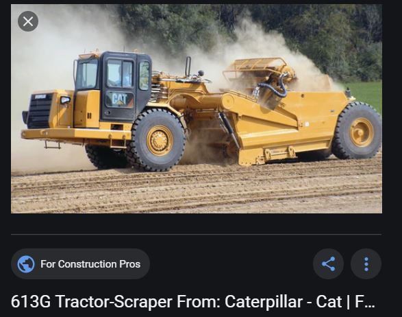

This isn't Allis related but I thought I'd ask you construction guru's a question. Around here in western Missouri the past few years I have noticed a lot of earthmoving contractors using pull type scrapers with 4wd articulated farm tractors instead of powered scrapers. Have any of you noticed this in your areas? What is the reason? Thanks.
