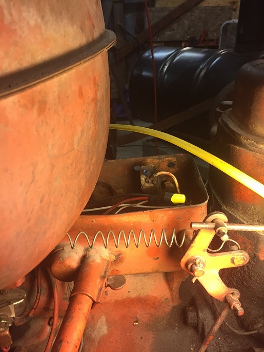

Post Options Post Options   Thanks (0) Thanks(0)   Quote SteveM C/IL Quote  Post ReplyReply Direct Link To This Post Posted: 13 Jan 2017 at 6:48pm
The quadrant springs are often overlooked.They also have a tendacy to not slip on the washers and torque against the travel.Dad used to give em a little drop of oil from time to time to keep em working right.

Post Options Post Options   Thanks (0) Thanks(0)   Quote DrAllis Quote  Post ReplyReply Direct Link To This Post Posted: 13 Jan 2017 at 4:59pm
The design requires that balance spring to be of a certain strength AND the one that puts pressure on the friction block has to be up to strength as well. It is a combination of the two, so start with the one under the tank and go from there.

Post Options Post Options   Thanks (0) Thanks(0)   Quote Stan IL&TN Quote  Post ReplyReply Direct Link To This Post Posted: 13 Jan 2017 at 12:44pm
Yep wrong puny spring.

Post Options Post Options   Thanks (0) Thanks(0)   Quote DrAllis Quote  Post ReplyReply Direct Link To This Post Posted: 13 Jan 2017 at 12:15pm
That balance spring has to be correct to ever have the throttle stay in one place. That one is a poor substitute for the real thing.

Post Options Post Options   Thanks (0) Thanks(0)   Quote BradH Quote  Post ReplyReply Direct Link To This Post Posted: 13 Jan 2017 at 5:08am
Thanks for the info guys. Shameless, it works, but I'm not convinced it's working right. My throttle won't stay put, it constantly slips up on the quadrant. I've got to replace the quadrant and probably the lower steering support bracket too. When I do that I'll replace the tension spring on the quadrant as well.

Post Options Post Options   Thanks (0) Thanks(0)   Quote Bill Deppe/AC Salvag Quote  Post ReplyReply Direct Link To This Post Posted: 12 Jan 2017 at 11:05pm
Labeled as a compensating spring, pn 70220923. Would have a used one if unable to locate a new one

Post Options Post Options   Thanks (0) Thanks(0)   Quote BradH Quote  Post ReplyReply Direct Link To This Post Posted: 12 Jan 2017 at 10:01pm
Got another question to take up more of your time here guys. The spring to the right and below the gas tank on my WD 45 isn't right. Or at least it doesn't look correct to me. I'm gonna replace it soon. Does anybody have a part number to look up to order one? Or at least what do you call the darn thing?
Thanks again for all the help,
Brad
Warning! Blind man with a tractor! Head for the hills!
