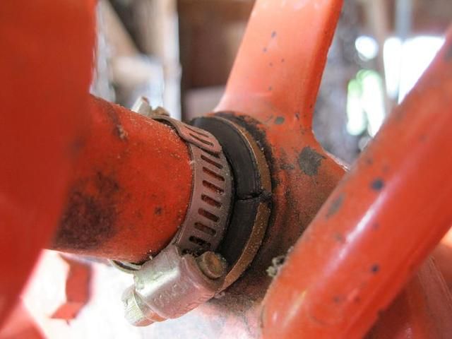

Here's what I did on a WD. Went to Fleet Farm and picked up a flanged brass bushing that was 7/8" inside and 1" outside diameter. Of course, the shaft and hole are worn a bit, so it should slide right in. The hitch in my giddyup was I couldn't get the steering wheel off. So, I cut the bushing in half, coated it in grease, put the two halves in. Then put a hose clamp on the shaft just above it to keep the pieces from walking out. Correct? NO. Functional? YES.

Looks good
