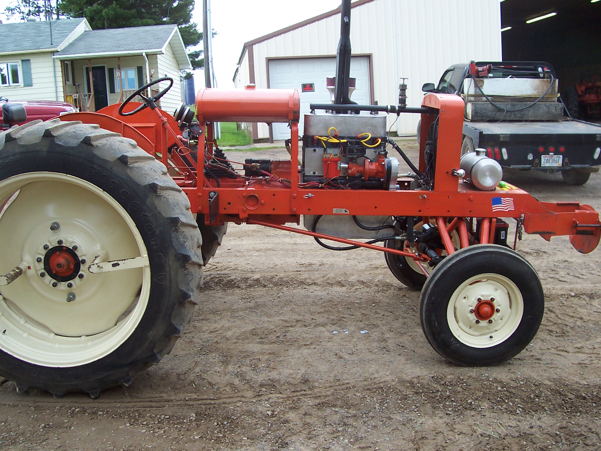

here is a pic of our pulling chassis even if it is off color.

i been working on  a set of billet alumnium heads and getting the engine adapted to the clutch can getting the spaceing right etc.    also got to make a new starter setup and pump drives off the crank nose as the block needs to get cut off where the original starter is in order to fit in the frame

Looks nice, light super??

This may be a dumb question, but when you get to that point is there even a tractor part left on there?

Engine and hoods only, but with the kind of hp they are making in the big classes it's the only way they should be.

NTPA is the only one I know of allowing 4wd (still has to be an ag engine) and crossbreeding.  I don't agree with either.  However running 2500-4000 hp through factory housings is not really safe.  Factory chassis are just fine for the Limited Pros on down.

bounce a cast tractor chassis around and see how much it will take or twist some axils comeing off the line and see how bad you want to climb back in.  i want to have my fun and i want to see how much power i can find but most importantly i want to put my little boy to bed at night.
