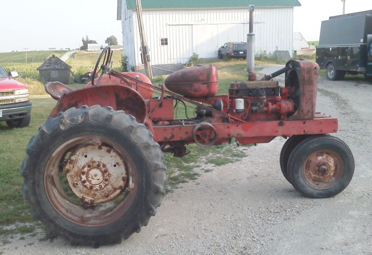

Okay, so in the past, you've probably heard me mention the '50 WD.  This one was rescued by fellow forum brother Chuck Ludke up in the Green Bay area several years ago... rescued from a nearby farm, probably saved it from a parting-scrapping death.  Engine was stuck, but not for long... took me about an hour to break it free, and had it running within a few hours.  Problem is, it wasn't holding coolant.  Some ended up in the pan, some in the #3 cylinder.  There was a patch across the lower edge of the water jacket, beneath the carbeurator.  After working on it, I found the typical crack between cylinders, but worse, the webbing between base of the center sleeves was cracked, so the sleeves lacked support.
My original plan was to replace the block,  pulling all the internals and transplanting them into a different block, and I managed to acquire a block, but business travel, neck surgery, house projects and activities with the kids provided with little time to finish it.
I recently got the opportunity to get a WD-45 engine from AJ in Indiana, had it picked up by a co-worker who was travelling through his area, and yesterday, a local buddy (IH enthusiast Josh Spicer) came down to join me in a wrench-a-thon.
We pulled the WD motor out, and dropped in the WD-45 mill.  Today, another buddy (drummer Mike, a virgin, but now convert to wrenching old tractors)  helped me get the intake/exhaust and ignition systems on, water pump in place, and a few other things.  I would have done these myself, but this morning I tore something in my arm (probably distal bicep), so my abilities are somewhat limited.  With the help of friends, it's gotten to within a few hours or test-firing it back into operation.
Stay tuned- More news later!

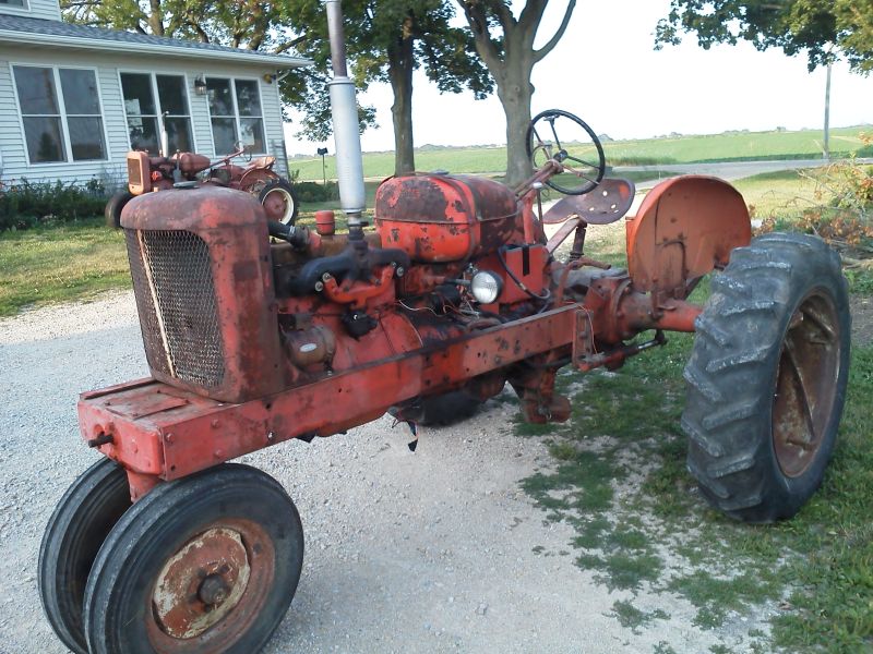

It's ALIVE!
Yep, got all the critical componentry back in place and connected, set the timing to something basic, and just about the time I was ready, the battery got too weak to crank it over. (rats!).  So I flipped the choke closed, stuck the crank in it, grabbed it with my good arm, grasped the crank properly, and pulled it past TDC... and it lit right up!
Sounds nice and stable, no valve racket, no barking or sneezing.  Does leak oil out the side of the block where the oil filter mounts... bolts are down tight so must be a bad gasket or something.  I ran it for about two minutes without the water pump spinning, but the radiator/block are full of water, saw no bubbles coming up... and no leaks coming out.  Dipstick is right midway in the good range, so I'll check it tomorrow and see if any of the status indications change... hopefully, all will remain, then I'll bolt the radiator and generator back in place, fix that oil issue, and fire it up (yeah, it's on the charger).
I love it when a plan comes together!!!

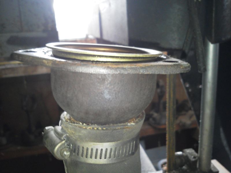

Anyway, this morning's exercise in futility:
Pulled the water neck to install a new t-stat... the NAPA 155, it's a 180F unit, looks like a typical modern automotive tstat, but comes with a rubber gasket (on top) and a brass skirt (on bottom).  The idea is, you assemble the works, and stuff it up in the upper half of the neck, install the gasket, and bolt it to the lower.
Problem is, the brass skirt is about 0.040" larger in OD than the upper half's ID.  I scrubbed the ID of the upper half, got all the crud out, and it simply will NOT go in... and of course, the assembly won't land flush, or seal at all, if it doesn't.
WTH??
I know I used this same part on the D17...  are there different variations in upper halves?  the one I'm using came off the WD motor... the D17 motor uses a different head and lower neck (back port is blocked with a plate, front port is bigger), so I'm using the WD45 lower and a WD upper...
Points: 8636
Post Options Post Options   Thanks (0) Thanks(0)   Quote SteveM C/IL Quote  Post ReplyReply Direct Link To This Post Posted: 05 Jul 2012 at 1:05pm
The parts book is showing different t-stat with different tops.WD no bypass VS WD45 w/bypass port. The base on late WD's are same as WD45's but using different tops requires different t-stats. No WD's used the bypass top. The 45 setup looks like the D17 I just worked on. Confused?
DaveKamp View Drop Down
Joined: 12 Apr 2010
Location: LeClaire, Ia
Points: 6069
Post Options Post Options   Thanks (0) Thanks(0)   Quote DaveKamp Quote  Post ReplyReply Direct Link To This Post Posted: 05 Jul 2012 at 10:59pm
Yeah, I guess so.  The lower neck doesn't have any special bypass passages that I see... just a gaping hole to the head...  top half doesn't have one either.  The WD setup didn't seem to have any bypass... it appears that the design was simple... that the only thing the tstat does, is restrict flow through the rad when engine temp is low.
Original WD tstat (the one that was in it, that didn't work) has a 3/16" bypass hole through the door... which allowed flow to pass (and bubbles to escape) with sufficient flow over the wax motor to open it up as the engine warmed...
The NAPA 155 has a fair amount of bypass cavity because of how it sits inside the brass 'skirt'...
I guess I don't know what to think.  I DO know, however, that the 155's skirt doesn't fit in the WD upper neck.  I did order a 55 (the 160F NAPA part, also spec'd for Allis WC, WD, WD45), so I'll have one in hand (bad pun...  seein's how I've got one arm in a brace) in a few days.

I'm swinging by NAPA on my way to the office, gonna take the upper neck along and see if the NAPA 55 tstat is in... it should be...  perhaps there's be a revelation...

the bypass is in upper hsg...WD45 and later. The early WD's had a 2 port water manifold then switched to front head port only on later WD's on up.

Okay, so I picked up the OTHER thermostat... NAPA 55... which is a 160F unit...
And the lower skirt is the same as the 155...  too big to fit in the neck going to the radiator:

Hi Trev!
Well, that'd be my first contention, except I WILL be running it in cold weather... probably -20F on regular occasion... I'll eventually fit a V-plow to the front of it, for busting through snowdrifts to get down the mile and a half of gravel to the highway...
I've been contemplating my options, and I realized that if I glued some PVC pipe sleeves and pipe segments together, I could probably get enough material built up, to machine down to make an adapter similar to this thing.  In reality, all the 'skirt' does, is make it so that it fits a standard automotive thermostat form-factor.  I've never found a situation where PVC was unable to take the heat, but if it winds up being too soft, I'll just make the danged thing out'a steel... that's what lathes and welders are for, right?

Well Dave I wish you could have stopped in had I known and been here. If I was in your stat perdicament [sp?] I would take the housing to the auto place and try and find one to fit, and I guess if you already have btdt then if vendors here can't help maybe tractor junkyard for a swapable housing like off a D17? I just replaced the 17 III stat and the XT and the 15 II from auto store so those must fit. Actially I would just machine what I had so the stat will fit probably and that would be the end of it.

Dunno, Captain-  I looked at my WC's, which have different housing arrangements... since this is my only WD, and I don't have a WD-45 (aside from this engine), I have no clue what's really wrong here.  On the up-side, it's been stupid-extra hot here the last 5 days or so, but seems like the 'fever' kinda broke a bit, so I'll be getting some stuff done outside, perhaps get a few minutes of sleuthing time in this afternoon and get something figured out.

Seems to me that 70210157 is the one you need...don't know NAPA's # for that or if their translation is correct(seen that before). I was thinking it was more-less the same as Chevy 's from 70's-80's. You'll figure somthing out.
