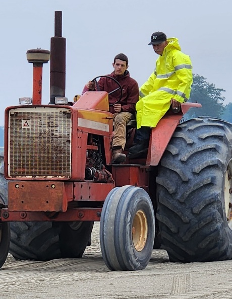

Must be a pretty good running 45 to pull that plow. I bet that makes her bark. Nice to farm table top flat farms. Don't think she would like to pull that here in Pa. on our hills!

Is that 4 furrow? How wide?? Wow.

4-16's...8 inches,2nd gear. Was giving grandson some fun. Wanted to take his place. Lol
