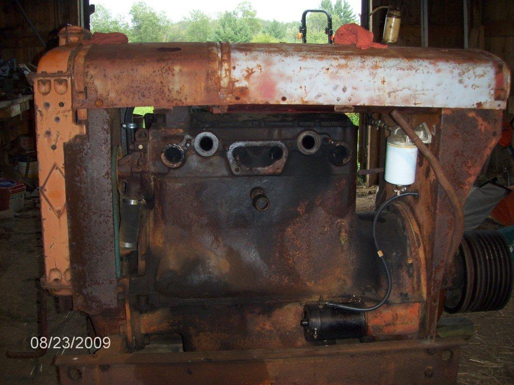

Points: 12
Post Options Post Options   Thanks (0) Thanks(0)   Quote Rickm Quote  Post ReplyReply Direct Link To This Post Posted: 19 Apr 2010 at 8:45am
Here is a pic with the manifold removed. Any ideas?

Post Options Post Options   Thanks (0) Thanks(0)   Quote GlenninPA Quote  Post ReplyReply Direct Link To This Post Posted: 19 Apr 2010 at 9:22am
From the diamond on the radiator support, I'd say Fred Lucabaugh would be able to give you a hint,or some help.

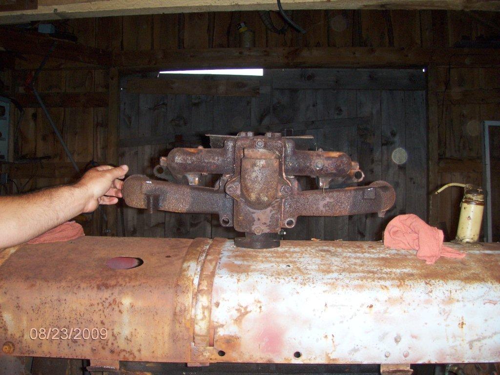

Post Options Post Options   Thanks (0) Thanks(0)   Quote Rickm Quote  Post ReplyReply Direct Link To This Post Posted: 19 Apr 2010 at 11:24am
Here is a picture of the manifold.

Post Options Post Options   Thanks (0) Thanks(0)   Quote Good Quote  Post ReplyReply Direct Link To This Post Posted: 19 Apr 2010 at 12:37pm
Looks like A "UM" engine they were used in u,uc and m crawler and if it is you can still get manifolds.

Post Options Post Options   Thanks (0) Thanks(0)   Quote Fred in Pa Quote  Post ReplyReply Direct Link To This Post Posted: 19 Apr 2010 at 1:26pm
UM Engine same as Later U's , UC , M Crawler . . What is the U-40 power unit. Ding Ding Ding .
