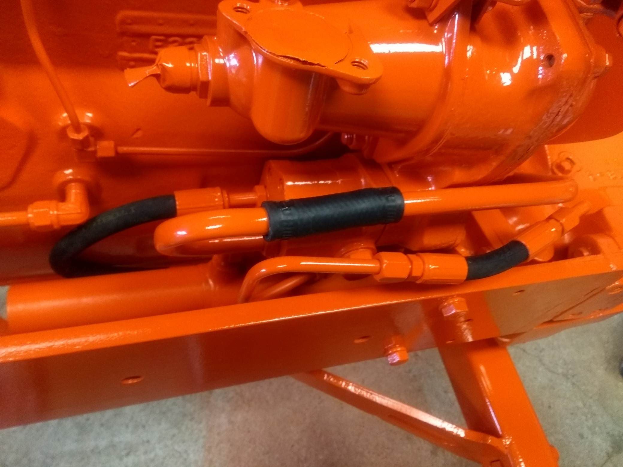

i need a new power steering hose for a D-17 ser3  agco does not have, what are you guys doing for replacements?

Take the hose off and go to a hyd hose shop. Around here, its colliflower, one warning, they are real proud of their work, if you know what I mean...Wink

I removed mine went to john deere
They made it while I had a cup of coffee. I think the one for my WD45 was less than 50 bucks. Pretty cheap in my opinion.

i would  but my hose is 1/2 steel and 1/2 rubber hose steel has a long pipe that goes down into housing

The pressure line/hose from the power steering pump down to the back of the generator and then underneath to the control valve (on a GAS tractor) could be pretty easily repaired by my local hose repair place. They would cut the upper and lower tubes off, leaving as much tube as possible, and making a new hose an inch or two longer to obtain the same total length of the assembly. They have special repair fittings that use a steel ferrule and a nut to crush it into the end they swedged on the hose end. It's a good fix and will still appear relatively OEM.

I took my 45 diesel power steering hose to my black smith, he cut the ends off both sides of the hose and welded them on a new crimp before he crimped it on a new hose.
Looks perfectly original plus it doesn’t leak anymore.
Talked to an Agco parts dealer and they wanted me to put adapters on and tried to charge me an arm and a leg for the set up.
If the steel section is good, cut off the rubber section and have a hydraulic shop make a new section with compression fittings on the ends, then it can get tightened onto your steel ends.  Have done it on a couple of D15s and hydraulic cylinders on Series 4 D17s.

the hose i need is the pump bypass or part number70237403

i got one ordered from A&W  thanks for all the help
