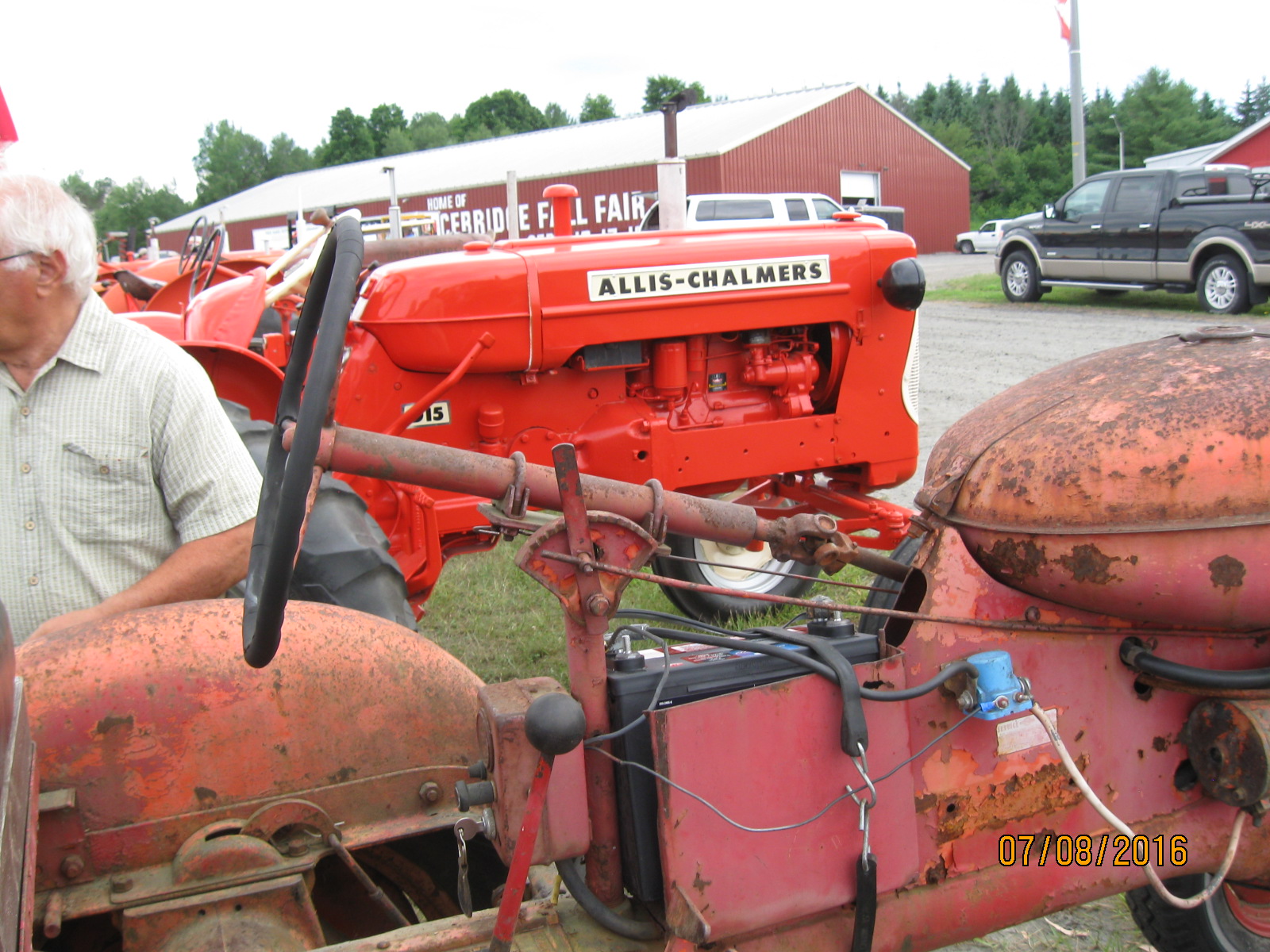

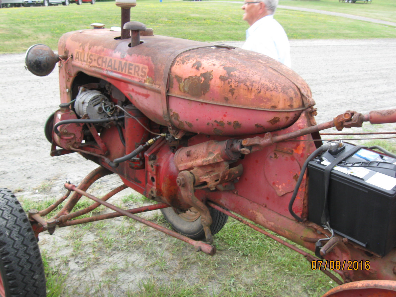

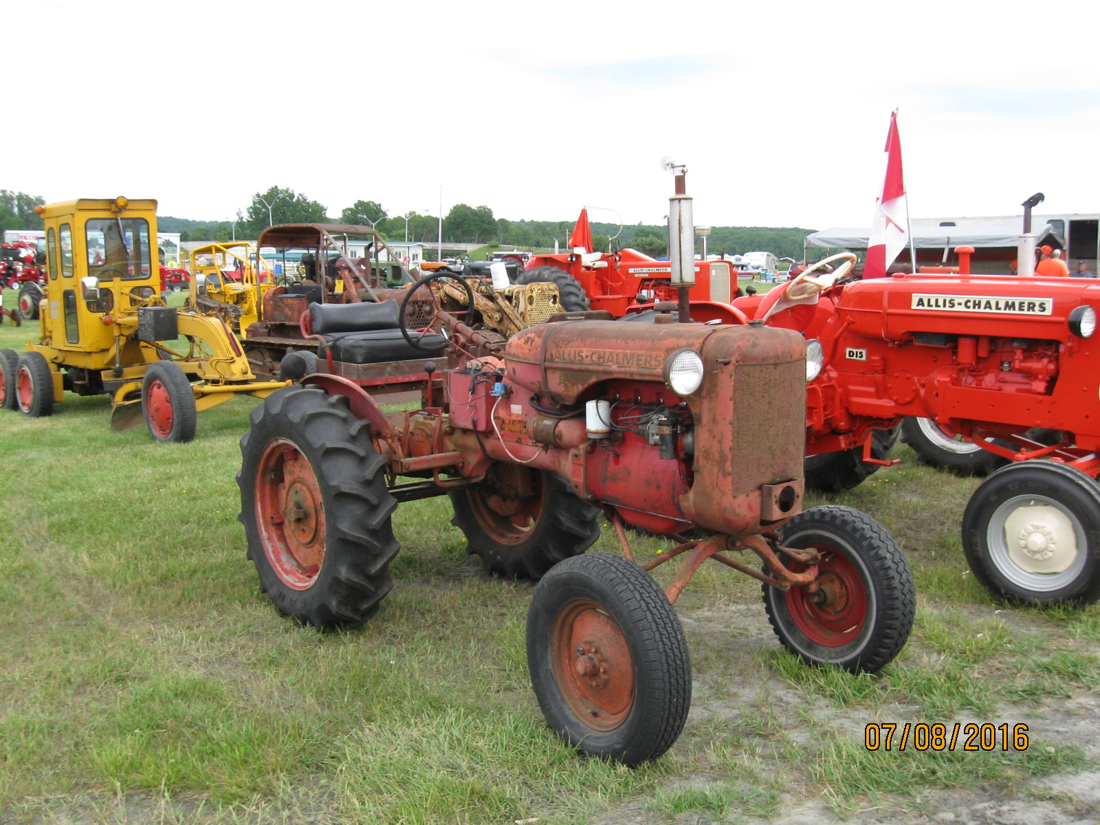

Is this not the neatest, best designed and most practical system?   Ross.            500 x 375
davh View Drop Down
Joined: 27 Apr 2016
Location: Kansas
Points: 117
Post Options Post Options   Thanks (0) Thanks(0)   Quote davh Quote  Post ReplyReply Direct Link To This Post Posted: 24 Mar 2017 at 10:57am
thoughts on what unit or vehicle that is off of?
