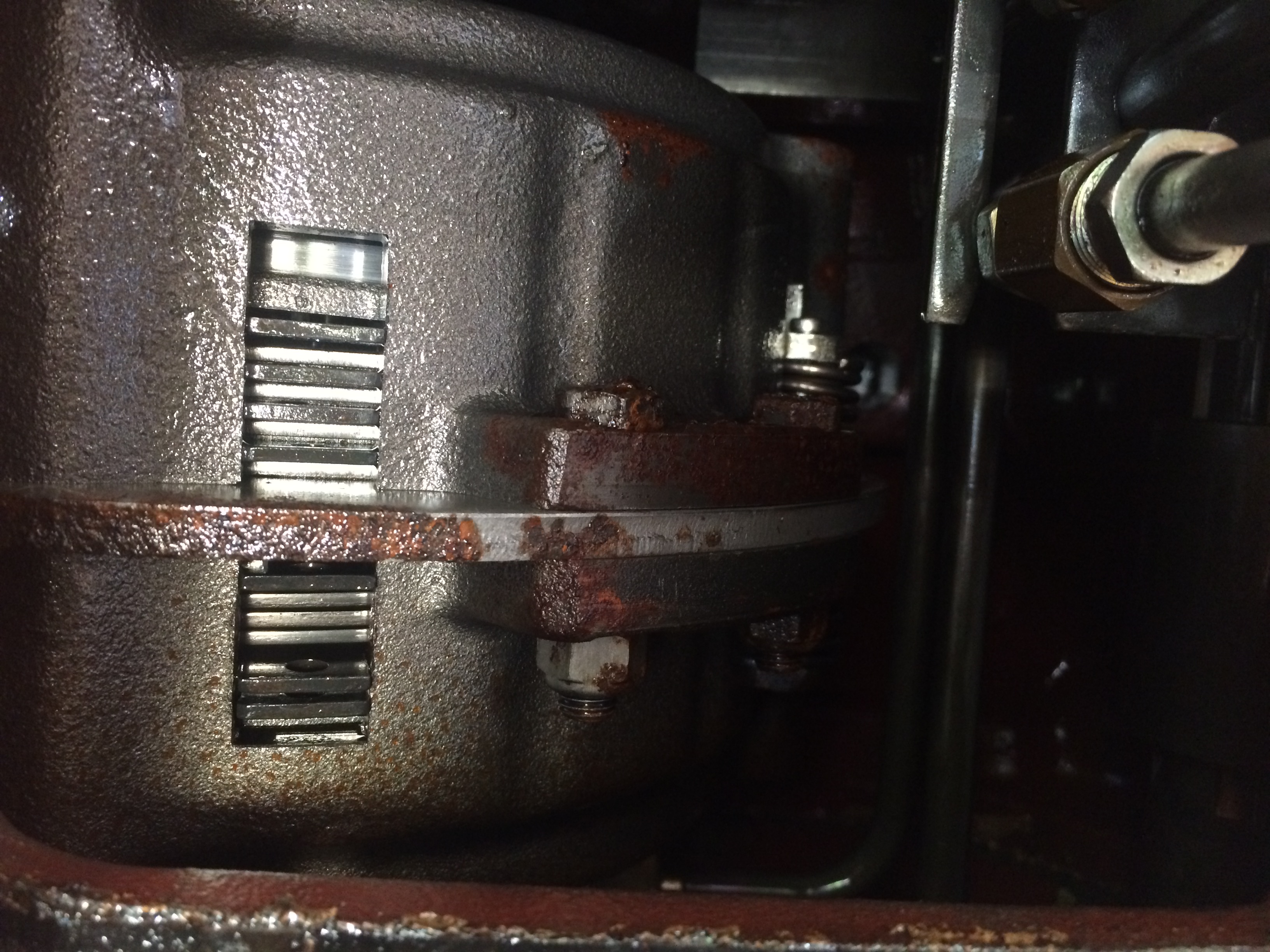

Ok, I got bored today so I locked the foot clutch down so I could rotate the PD assembly. YIKES! It's ugly in there. My guess is the back clutch came apart and the bits jammed in there in such a way as to fuse the thing. I pulled the sump and the gears look great. I suspect the splines are stripped out of the low range frictions. Hope the pic came through.

That is a mess. It's a pretty simple clutch assembly to rebuild once you get it out.

Be sure to replace all 9 discs with new 70261212 discs from a 7000.

and re[lace the lock nut with a new one when the nut works its way of  its a real expensive mess to fix  1.50 nut cheap insurance
