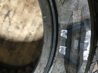

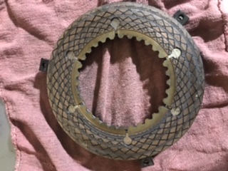

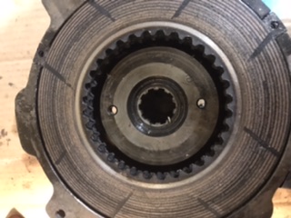

Ok I put a few pics, the clutch plates are not all that bad I guess. The grooves in the plate are exaggerated by the pic. I can just grab the indentation with my thumbnail. Am I trying to fool myself or is unacceptable condition to use this tractor for brush hogging a few times a year for 2 1/2 acres. Been using it all along with no PD as it is.
Edited by Brad1 - 4 hours 37 minutes ago at 4:36pm
Points: 22337
Post Options Post Options   Thanks (0) Thanks(0)   Quote DrAllis Quote  Post ReplyReply Direct Link To This Post Posted: 7 hours 24 minutes ago at 1:49pm
Ramp plate(s) pockets for the rollers that look like those will surely jump out of engagement when the engine is running wide open throttle. I see it has two different driving disc styles, which means someone has been in there before. A missing nut ?? Have you removed the tin pan under the PTO drive gear area? which is just ahead of where this clutch is located. What I see, if the discs and steel plates aren't warped, they will work as-is. Get it shimmed properly with new ramp plates and keep 2+ gallons of oil in it and you'll be fine.

The other ramp plate is worn more than the first ramp plate I posted. Yes clearly someone was into this and really made a mess of things. At this point I would have to have new ramp plates in your opinion? Could they be built up with weld and put on a surface grinder then touch up the ramps with a small die grinder? Have you heard of such a thing? Good used ones are probably non existent?
Points: 22337
Post Options Post Options   Thanks (0) Thanks(0)   Quote DrAllis Quote  Post ReplyReply Direct Link To This Post Posted: 4 hours 11 minutes ago at 5:02pm
That is JUNK. and is the cause of the hand levers jumping into neutral when you throttle the engine up to wide open.  Sooo, the inexperienced shade tree wrench feels quite safe in thinking he can "shim" things around to make it stop jumping out, which doesn't work. A & I used to have them. I've never had any built up, so I have no experience on that. If you do, remember every time you snap the lever into engagement, that's one more time closer to being worn out it is.  If you could find a PTO clutch out of a D-21, they might be pretty nice, as that clutch may not have been used much at all over the years.
