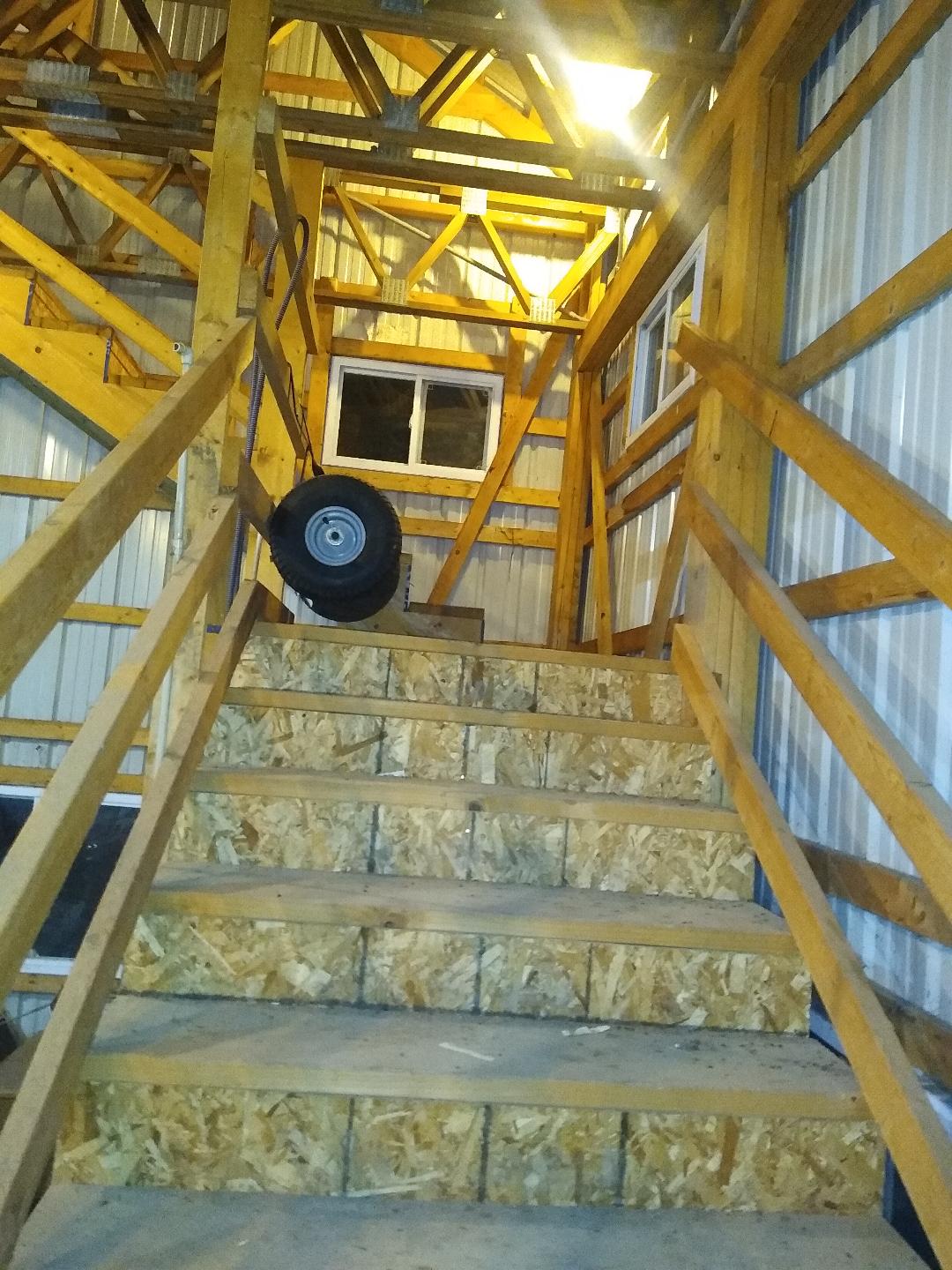

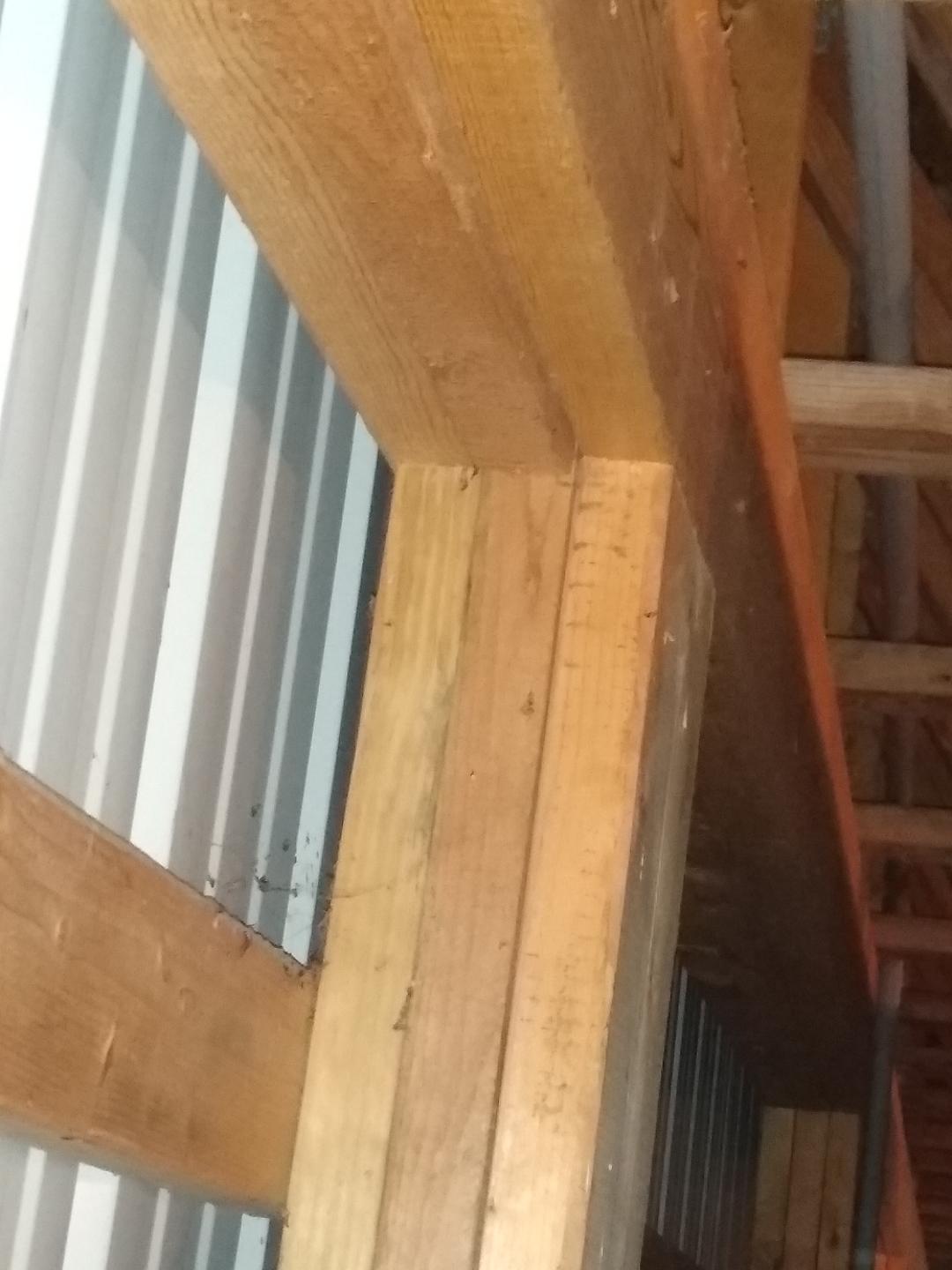

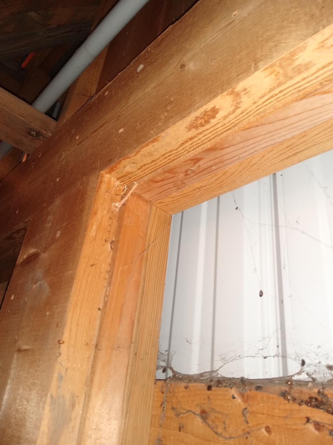

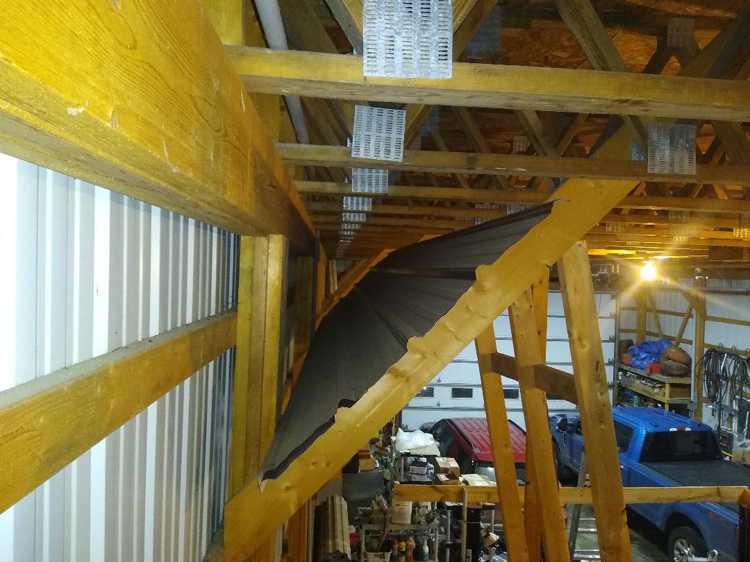

I have a friend that is a contractor that has built a lot of pole buildings. When I built mine (2011), I tried to get him, but he was already booked for the next 18 months, but he did give me a lot of advice.
We started out digging the holes to a depth of a minimum of 5'. "Frost line" for our area is 4'. We tamped the bottom of the holes, then put in about 6" of 1A (small) crushed stone, then about 6" of concrete for the pole to set on. Next we set 12" cardboard sonotubes, placed the started poles in the tubes and poured dry concrete mix in the tube. He told me to be sure to have straight sides for the concrete (sonotubes). He claimed tapered holes would eventually result in the frost lifting the concrete and thus lifting the poles.
His recommendation was laminated poles. He advised using 12' pressure treated 2x6's. Cut one into a 4' and 8'. Put a full 12' 2x6 in the middle with a 4' on one side and the 8' on the other. Space them 8' apart. After you are out of the ground, used not treated 2x6's to your desired height. I used 2x8's. His (sarcastic) comment was "It's your money. If you want to waste it, go ahead".
The poles are positioned so the 2x8 laminate goes the same way as the purlins. The top beam (where the rafters set) is also laminated, but 2x10's at the top of the post, the center 2x10 fits directly on top of the middle 2x8 of the post. One side of every post goes flush with the top of the beam. I used 16' 2x10's starting with the joints spaced evenly.
ON ALL LAMINTES (POSTS AND BEAMS) DON'T SCRIMP ON CONSTRUCTION ADHESIVE!!!
My building (28' x 60' with a 16' ceiling) is a little different than most because I have an upstairs. I have clear span 28' floor trusses with 3/4" tongue-and-groove OSB flooring upstairs. I have 2' of straight walls above the floor and ledger board rafters with a 7.5/12 pitch. The rafters are 24' 2x6's with about a 2' overhang.
Edited by WF owner - 05 Mar 2023 at 6:23am

I would like to see pics of how it ties at top of laminates with floor. Thanks, Tracy

For a 16' span, I would definitely look at LDL's or a manufactured truss for a header.

That looks impressive. Super heavy looking! First time I have seen laminated column turned that direction. Thanks, Tracy

I was lucky to find used floor trusses on Ebay for $30 each. I had the trussed a couple years before I built the garage. Since we do a lot of lawn decorating for both Halloween and Christmas, the upstairs storage is handy, but a few trips up and down the 35 steps is tough on an old man!

 I do want every bay on open side with a 16 foot span. Thinking 3 sides enclosed with 4th side with bypass doors. Not sure how deep yet but looking at 30 foot plus. Wondering what the best way to header over the clear span is?Don't want any sag. Could bar joist them, or sandwich a piece or flat sheet between header boards. Any comments welcomed. Tracy
If you are thinking that you might ever want to put two vehicles side by side (like in my picture above), consider going to an 18' door, rather than 16'. A friend of mine that had a 16' door in his garage suggested it to me and the door you see in the picture is 18'. I have never regretted the decision for the wider door.

It's tough to tell in the pictures, but at least one of the 2x8's in every pole goes through the top beam.
