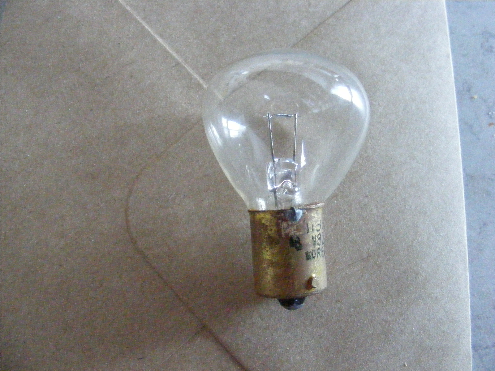

This is the type I run in all my 6 volt Allis tractor lights  It is an 1133 single contact headlight bulb and is rated at 32 candle power.  It throws a lot more light than the smaller bulbs used for turn and brake lights.  Most of mine also have new or very good reflectors and I have good lights for night driving.

PaulB:  I found out the hard way, by trying them!!  The specifications are often wrong, missing, or not correct, which is why I decided to post this, and yes the 1133 filament bulb is readily available and works, but the new CHIN*S* LED bulb throws so much more light and makes the tractor so much more useful at night!!!!
