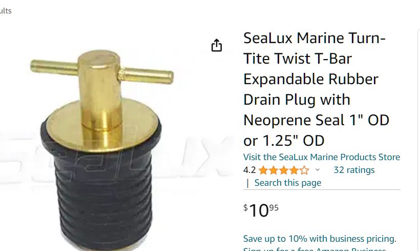

what size do you want ?  .. You can get with a NUT on top or a TEE handle / etc..

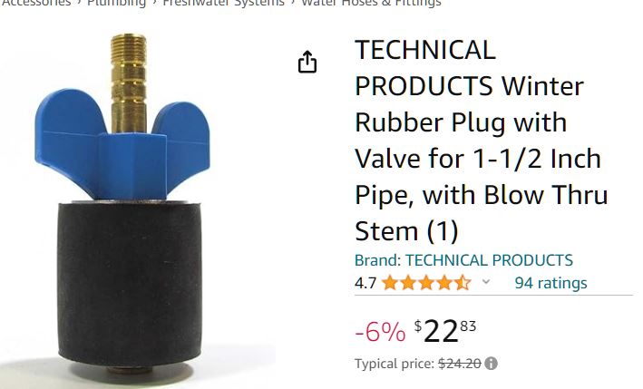

i would use something like this... put a bigger washer on top so it does not slide down in the tube.. and put a short 90 degree rubber hose on top of the "vent" to keep dirt out..... again,verify tube ID.

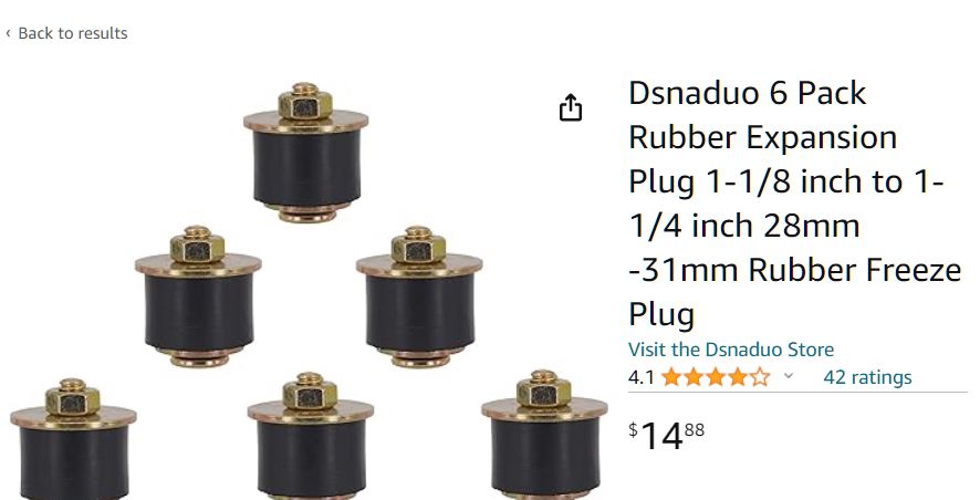

well.......... this would be simple..
